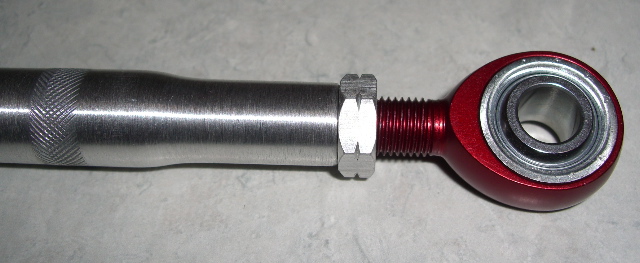

Hopefully I'll have up some photos of my assistant later this week. I ordered some fancy racing heim joints that USPS tried to deliver on Saturday, but I was away at a Work on Cars Day in Sacramento. I should have the package today, so tonight I'll make a new, super duper lower stress bar with adjustable heim joints rated for over 4,000 lbs each. Unfortunately my assistant has to work tonight, so I may have to take photos without her. :angry:
I'm doing all three stress bars in the back with this new setup. I also bought some parts to see if I can use these heim joints with special spacers to make sway bar drop links (one of mine has a bad seal).

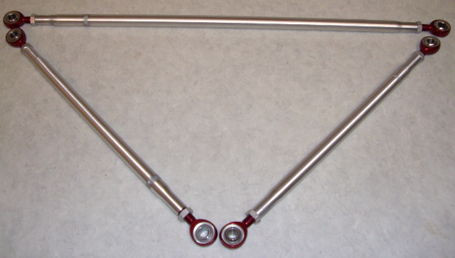

Here are some quick pics of my new and improved lower stress bars (all three). The large main bar ties the left and right sides of the car together. The two smaller bars then tie the left and right sides to the support in the middle/rear of the car, thus triangulating the three bars together and giving extra stiffness.
Basically I've been running with a homemade setup like this for a couple months and really appreciate the improvement. Now I've taken it a step further by upgrading to light weight and stronger racing components. I'm going to take these parts to work tomorrow and weigh them before I install them. But they're really very light weight. The rod ends or heim joints are three piece (not the cheap two piece) units made out of hard anodized aluminum. Each heim joint is rated to hold over 4,000 lbs! The bars and locking nuts are all aluminum too. Man this is a slick setup. I can't wait to get them on the car!
