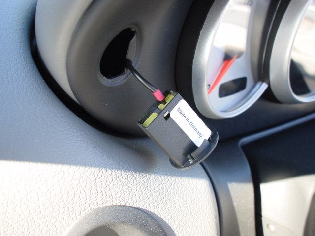

The CDR-23 radio that started in 2003 does not have the GAL function if you have the Bose option. GAL is replaced by AudioPiolt. A microphone in the instrument cluster where we usually have a dummy grill for the cell phone mic we never had in the US.
