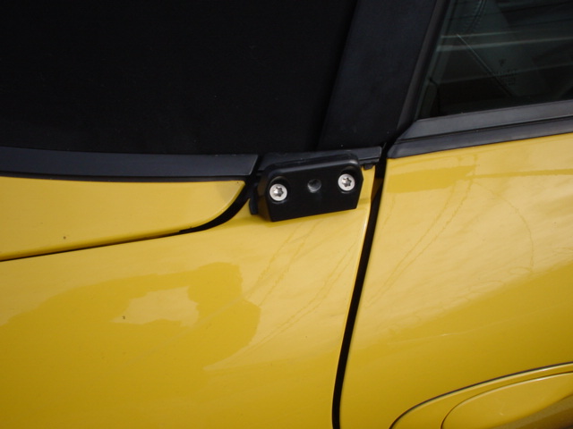

Do you have this mount?
No, I have the original hardtop only mounts, and the soft top only mount. The hardtop only mounts mount on the hardtop, the softtop only mounts cannot be used with a hardtop because they curve in. When they revised the RTS they made one mount that is for both hardtop/softtop use.
I want to use the ones that are hardtop/softtop compatible, like the one you pictured. My question is:
Can you use these new mounts on the older style RTS? Do you have the PN?

I hate bumping old threads, but wanted to give a little UPDATE the will hopefully help people in the future.
There are two types of RTS (Roof Transport System), the old one and the new one. The old one came with two mounts one for the hardtop and one for the body of the car. The RTS was upgraded at the same time the hardtop lost the, "ears," to include only one universal mount.
I have an original RTS and a hardtop with ears. After driving with the RTS mounted on the the hardtop, I got some noise issues due to the extra weight on the top. So I tried the body RTS mounts (pictures above, thanks Tool Pants), with my hardtop. They fit just fine, I was hesitant because I though because it had two mounts one for the hardtop and one for the soft top, but I was wrong. The ones I thought were for soft top only use, work just fine with the hardtop, and although the part number is different from the newer RTS mounts they appear to be identical.
So apparently if you have an older RTS you can use it with any hardtop, via the body mounts. And if you have the newer RTS then you just have the body mounts, and that works too. I am going to switch to the body mounts to hopefully eliminate the noise the RTS caused through the hardtop, keep the top from flying off of the car if I am ever in an accident, and add a "roll cage" to my Boxster.
