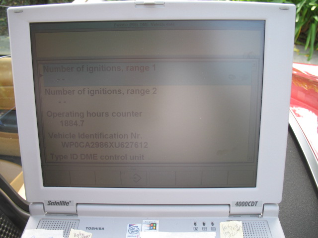

Now, if you would like a nice 1999 Boxster with 1,884.7 operating hours, and no range 1 or 2, then let me know....
