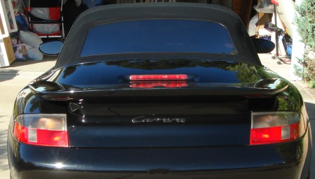

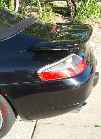

Here is mine with recently installed TechArt, MKII Side Skirts and '02 GT2 front spoiler lip.
Install of all was a breeze! Paint for skirts and rear wing was ~$575
How much were the individual parts and where'd you get it Midlifez? Does it auto go up and down still, or is it just like that? Any more pictures of it and the rest of your car, I really like the look of it, not huge GT3 wing (which looks nice, but isn't for me on a street car) and not one of the whale tails, which isn't to my taste.
I'd like a front lip too, if anyone knows of a company that makes one, that would be great, otherwise I'll have to wait to do the whole front bumper piece. Which again I will likely follow your car again midlifez, it looks very nice.
The parts costs were:
- Rear TechArt spoiler: $850 from Suncoast These are not listed on their site and normally cost MUCH more than what I paid. The one I got was one that they had installed on a customer car and had some very, very minor cracks. Was able to get repaired for about $100. I chose the rear wing because it was good quality part, great price and like you did not want one that stuck up too high. Overall very pleased.
- $65.00: 3rd brake light/fan wiring from Suncoast
- MKII Side Skirts: $650 from Suncoast Suncoast MKII Skirts Link
- '02 GT3 Front Lip; $221 from Suncoast
The rear spoiler is fixed and basically replaced the entire OEM movable spoiler and mechanism including the grill area. Fitment was perfect. I installed all the parts myself, very, very easy.

Below are some more pics of my 996, before and after... Since the pictures were taken I have replaced the 3rd brake light with a grey colored one that is lit with LED's. Matches very well, did not like how the red OEM one stuck out like a sore thumb.

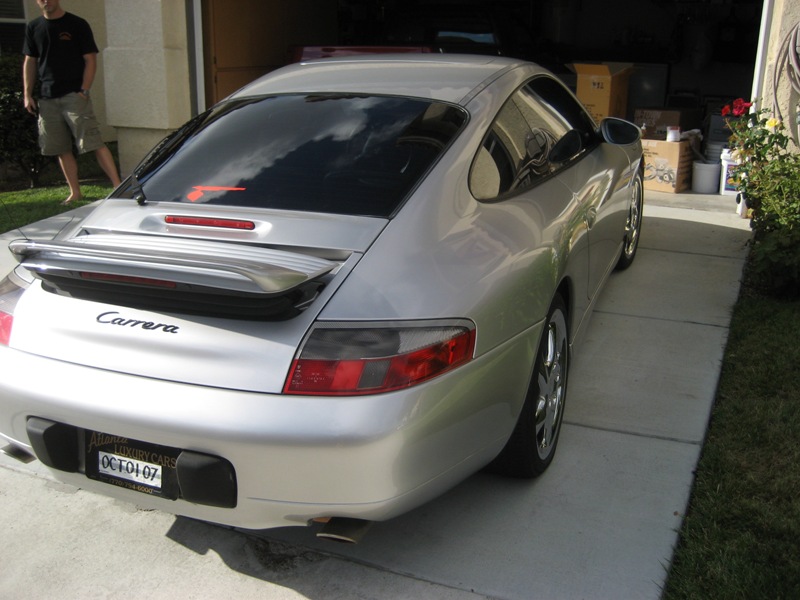

I got the car with this spoiler already installed, but it's definitely one of my favorites; it's clean, unobtrusive and understated. I'm one of those people who abhors whale tales, and I love anti-whale tale spoilers.
I do have one complaint for it, though: The left side of the spoiler has recently detached from the car. Now, I've tried five different adhesives (silicon, gorilla glue, crazy glue, aircraft epoxy, auto epoxy) and it's come undone every time. I still can't believe aircraft epoxy didn't work. Anyway, the spot I'm gluing is looking worse every time, so I'm over adhesives as a solution.
How do I fix this? It looks like there's a plastic peg that connects the other side (which has fortunately been strong enough at speed for the past couple of months). Thank you in advance.
