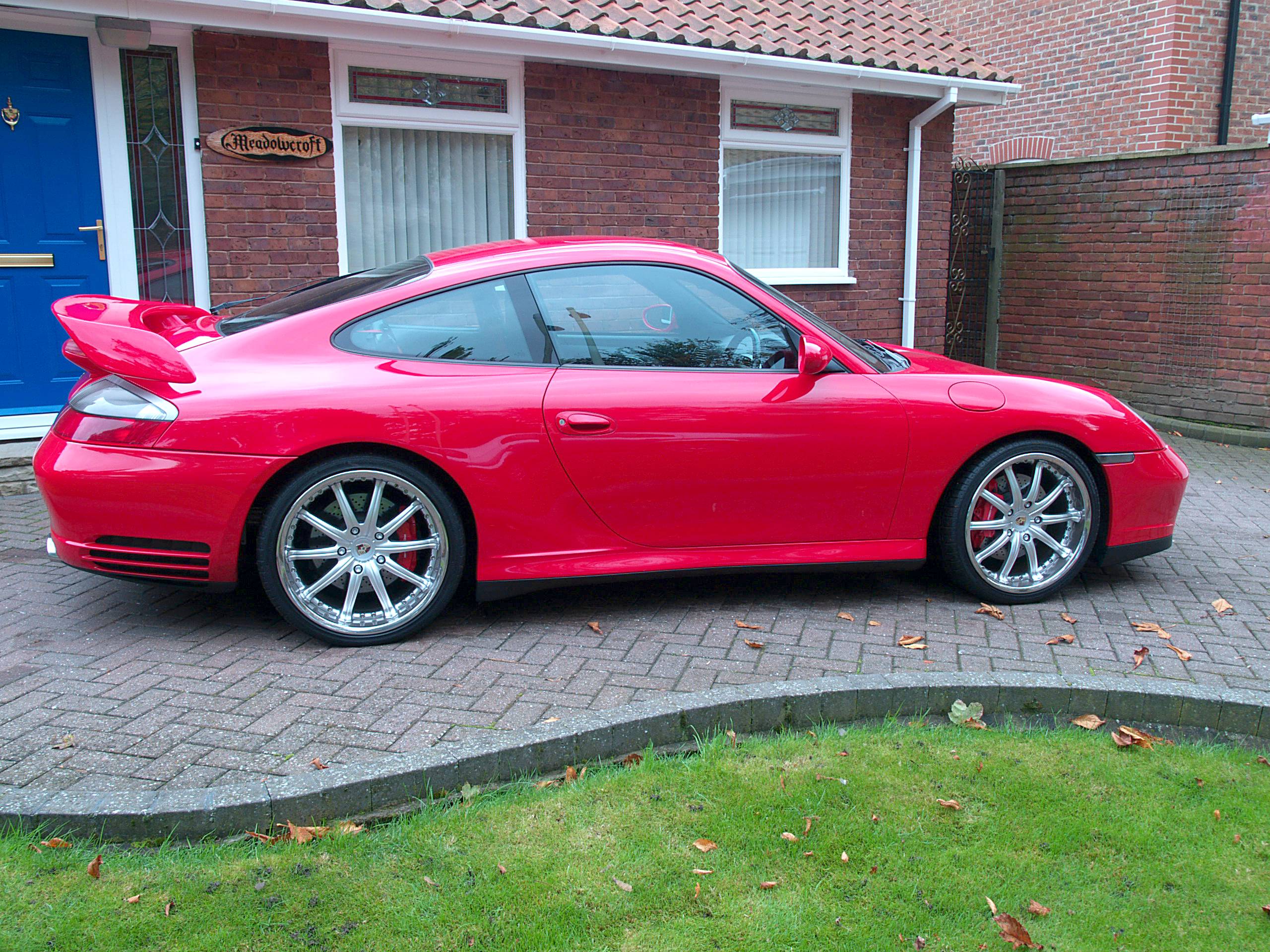

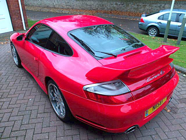

Hi I have just recieved my Misha GT2M wing way over the pond, here in the UK. It came very well packaged 'Un-damaged' and a very good moulding. I ordered it and paid by wire transfer [a little risky but I was right to trust him] It was shiped on Monday the 15 Oct 07 and received here on my door step on the Wednesday. I was given a Tracking number for FedEx annd was able to 'track' it's progress. It comes with a CD within 15 min's of 'scanning' that I was in the Garage and the Electric one was removed. The wing went to paint on the Thursday. The Guy saying "these modern mouldings are getting very good....this is one of the best I've seen"
Got it back a day or two ago sprayed laqoured and a perfect colour match. and an hour or so later she was fitted and it looks OUTRAGEOUS!
I can Highly Recommend them ....you will need a small length wiring harness Porsche Part Number 996-612-070-51 if you trim off the wires to the old electrics a 'warning light ' will come on at 75 mph as the computer is trying to raise the old spoiler...........this harness is for the fixed wing cars. .....Jobs jobbed!

Hi I hope from the photo [just one of 200 pics sent on a CD with the wing] you can see the Air Vent just clips straight back to the original spot and the Fan re attaches to it's original mounting so the engine lid, hinges, and catch all remain unaltered it's an easy if slightly 'fiddly' fit but like you I think it looks 'Awesome' as you Americans might say [just kidding!] I've sent off again to the states for the Techart type 2 side skirts again they will be colour coded at the same paint shop and in this case fitted by them. They will use pop rivets along the underside and then 'primer' and 'sika flex 255' [same as fitting a windshield] along the top side] I will post some pics when these arrive and are fitted..... Think they will look Outrageous!
I highly recommend the Misha Wing It turns heads that car.....it gives it Huge 'prescence' BUY ONE
I have recommended it on the UK porsche Club....but not to anyone who lives too close to me I want to be 'Unique'
