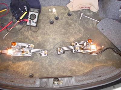

I don't know about US cars, but on UK cars they are only connected on one side. Porsche usually fit bulbs to both sides, but only one works.
On a US car only the left side fog light works, but not the right side. On a US car the right side bulb holder for a fog light is empty. On a RHD car the opposite is true, but sometimes there is a bulb in the non-working socket. No clue why Porsche puts a bulb in a socket on a ROW car when there is no power to the socket. So, ROW people treat this bulb as a spare.
To confuse you more, if you put a bulb on the right side it will not light up. The wiring diagrams are misleading because they show a wire running to that socket. And, if you pull out the bulb holder for the right side you will see a wire running to the empty fog light socket. If you put a bulb in that socket it will not light light up because there is no power to the wire. That is why you have to run a jumper wire from the wire to the functioning socket to the wire to the non functioning socket.
At least this is the way it is on my 1997 Boxster. As you can see I ran a jumper wire from the left bulb holder wire to the right bulb holder wire, put a bulb. So there is now power to both sockets and both bulbs light up. You would do the same except remove the left side bulb, so that only the right side would light up.
