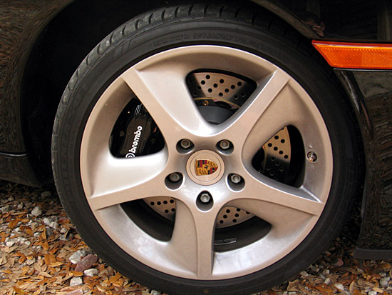

The stock brake suck for track use. I ran into lots of fade at Sebring, specifically coming out of turn 6 and into turn 7 (the hairpin). I installed 14" Brembos and I no longer have any brake fade.

My thread is also kicking around here, but I just upgraded my stock brakes to Boxster S brakes on my 97.
Total time for the conversion was about 4.5 hours
I got the kit from Suncoast for $1,550 on eBay. Ric at Suncoast has said he CANNOT offer the kit to anyone at the same price, but can come close. He can be reached at 877-923-1700, opt 2.

I also wanted to add, they use a group called Race Technologies to make up the kits. The rears come with specially machined rotors and two little spacers for the each caliper.
The set-up went one easily with just one minor snafu.

Bummer he can't do any better than $3K. I can tell you though, the upgrade is totally worth it - now that I have broken them in, I've been able to test their limits - and the braking is definitely more effective than with stock. A really tremendous improvement.
