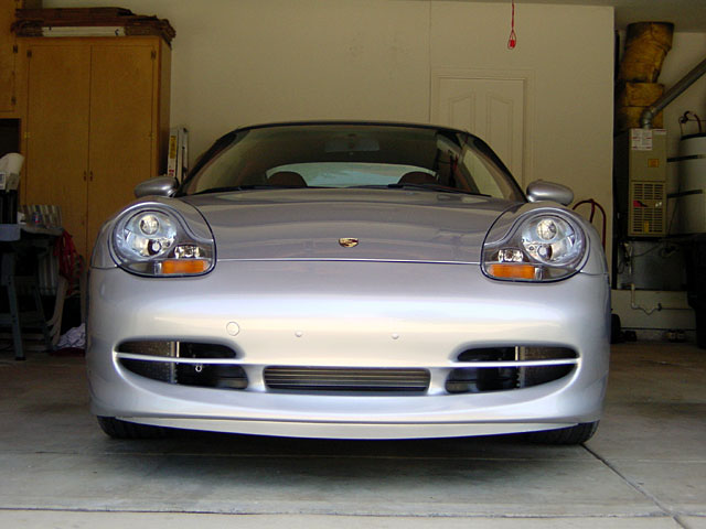

Did I do something wrong then? I just had the GT3 front put on my MY00 but do not recall anything about a front lip or expanding rivets. I guess I need to order that seperately? Is it a piece that is painted as well? Maybe a picture of it would help if anybody has that?
Dell
Lower small lip in this photo. It comes in black and can be painted. On the original GT3 it was not painted. (I have a spare and if I damage mine I will likely not paint the new one).
:P Mine is already black so if it is a good quality flat black I also will leave it!
Looks great! Also can you "cut out " that center piece for the third cooler?
Jim
Edited by CO996C4
CO996, Yes you can "cut-out". The middle section default is filled in. Just have to cut out if you do the 3rd radiator.
