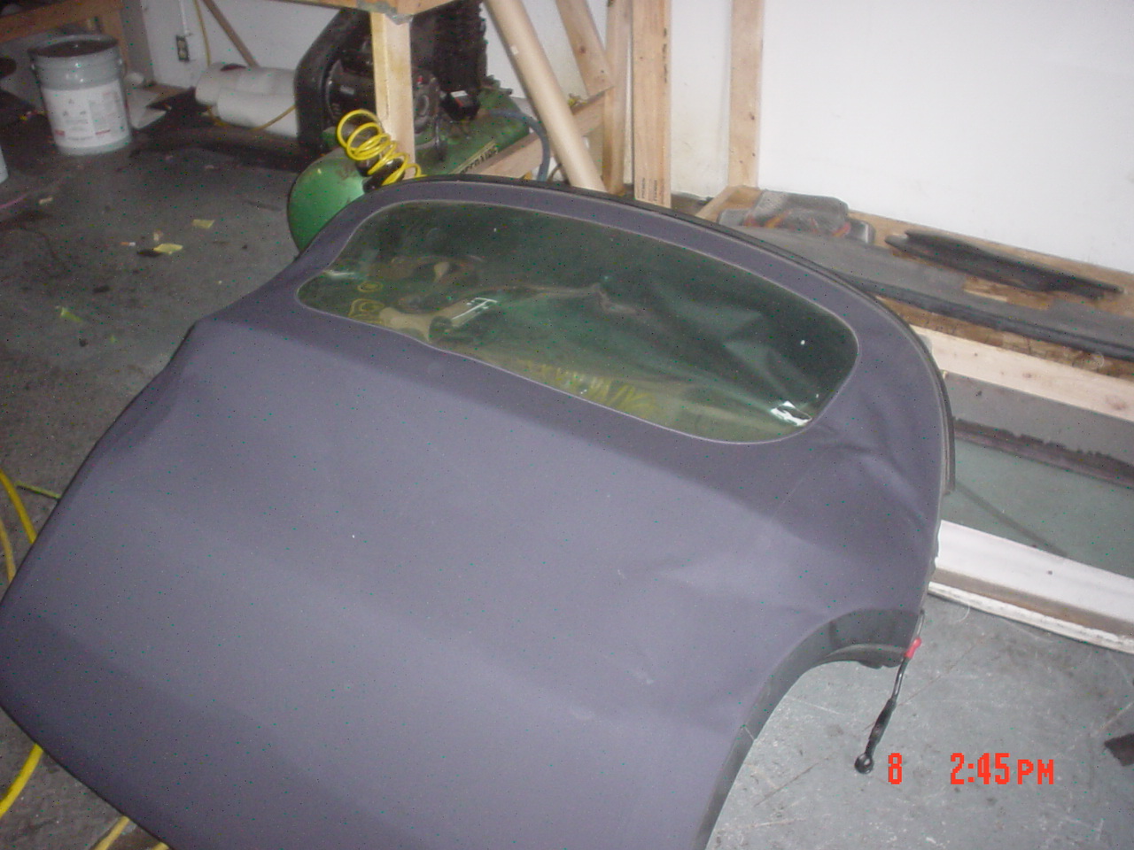

Customer dropped his car off about 2 PM to get his rear window done-99 Boxster S Midnight blue. So I thought to keep this post goin-

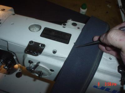

Many ppl asked which is eaier to do:with the top on? or off? However this time it was donw with the top off and JUKI machine stitched in instead of hand stititchin!

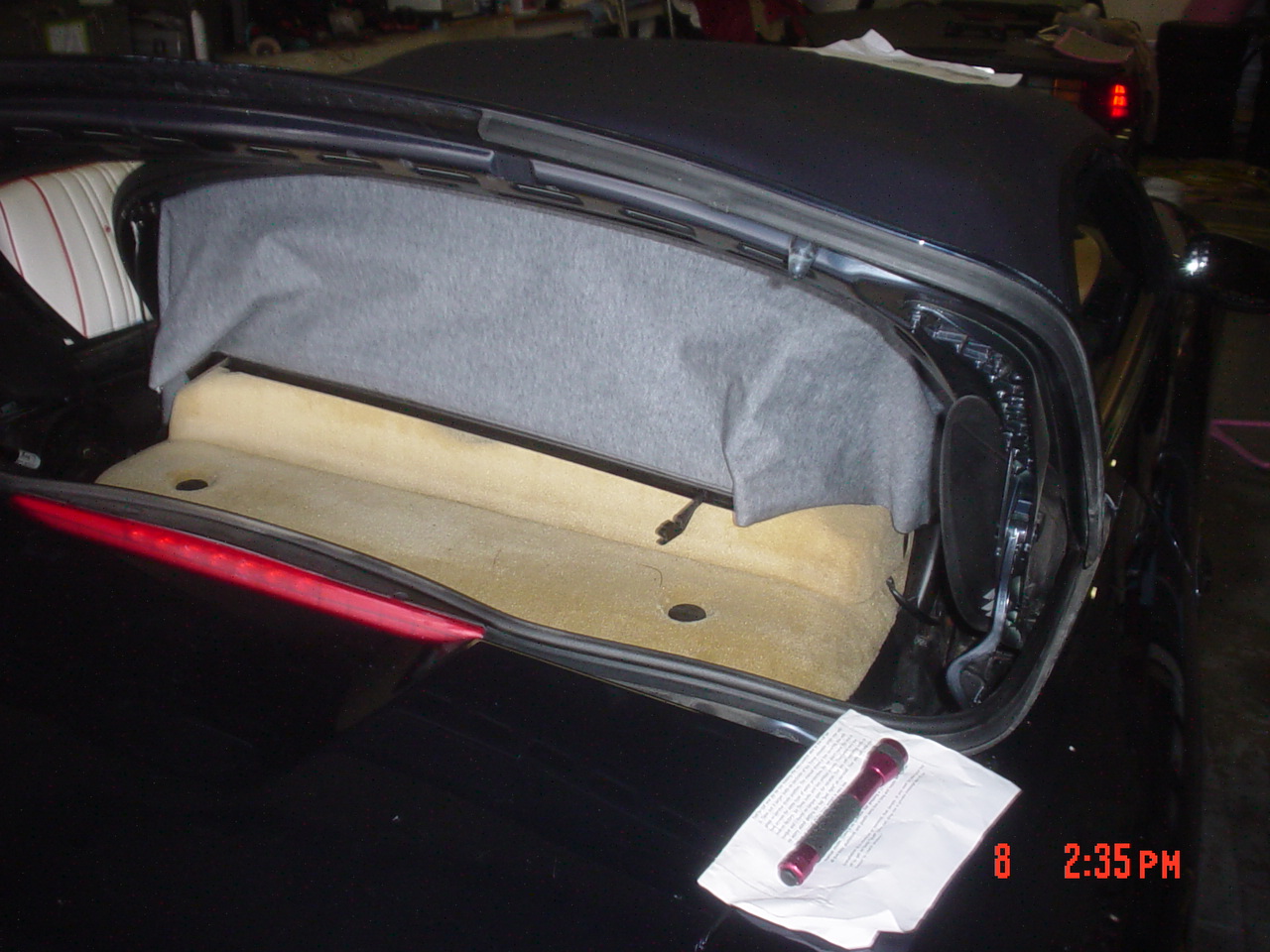

I believe how to remove your top was pretty well explained by rsfeller & 1schoir!
post-23680-1194584235_thumb.jpgclamshell at 45 degrees, back cables detached- just pop it out

A few times I've sewn in with the frame on it,,, unless u are a professional upholsterer this can be very difficult.
U will need to remove the canvas bottom piece.
detached top
bottom piece removed
JUKI time
