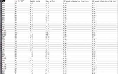

Are both of these from the same sensor and which side is it? Left standing at back of car. And is it possible to test by swapping cables on O2's? Added some data of my Custom supercharger at idle from the duramatic realtime log. Note the before and after readings on O2's conv.

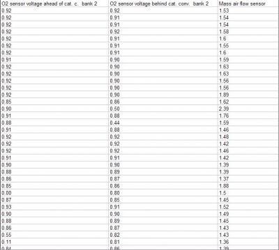

My main concern in the graphs Loren is that I do not want to run lean and not sure where I am at this point with the O2 voltages as my guide?

What is O2 resistance showing? the O2 itself? F7. and 8 are bank 1, and F11/12 are bank 2.
The second graph are of the voltages both sides.

The best advice is to take it to a reputable diagnostic porsche tech. Looks like one of your Upstream O2 sensors is locked on the lean side and its coresponding downstream is also on the lean side which typically indicates a bad cat converter. The data logging you have is really worthless, what you need to do is use a Dvom and monitor the voltages---force a rich and lean condition to see if the O2 sensors respond properly, switch rate from rich to lean on a good sensor is less than 100 ms. So thats pretty fast. If you cant take it to a tech, perform a hard reset and see if codes return.
vizcarra44 :P
44, Not sure what you mean I am using Durametric software and not familiar with DVOM, the O2 voltages are in the first data pictures above take a look. How do you force a reading? If you rev engine would this not acheive the same results? What do you consider a hard reset?
