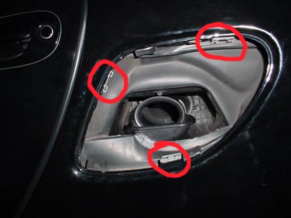

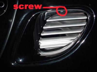

1.) Un-screw the one phillips head screw at top center of side air intake...
2.) The molded air duct and the intake grill are still attached by three delicate plastic tabs at the three points... The best way to remove this is gently insert your fingers through the grills into the intake at the points circled in red and gently try to free the tabs... All three points come forward towards you, but if one is stuck or gets caught it will break...

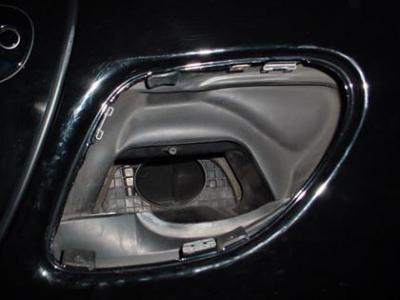

3.) Inside the drivers side air duct you will find a snorkle... The snorkle is added to most US cars for noise restrictions. Now this piece is attached by no screws or tabs, but it most likely will give you some troubles removing... The best way is to remove this, just grab a hold of the long snorkle (not the small dish on the end)... Now wiggle it from left to right and vice versa while pulling out towards you. This works, but might take a little effort.
4.) This is what the intake is going to look like after the snorkel is removed... Just carefully insert the three tabs back into their points... Make sure that all three are tightly in by pushing the airduct cover (not the grill)... Insert your 1 screw into top center of cover and you are done.

No, I haven't been able to de-snorkel. The right side comes apart as described in an earlier thread - push the grille in, it frees up the duct and it comes loose. The left side doesn't want to cooperate. Like the grille and duct are one piece. Tried to push it in but it doesn't budge.
Suggestions?
Did you try to slip your finger through the grill then try to free those 3 tabs? they should all come towards you.

Yes. Tried to get the tabs holding the grille to move outwards, releasing the grille, and tried to get the grille to "pop" in, releasing the duct. Nothing want to let go. I have pushed and pulled pretty hard, as hard as I think I should on plastic parts. Tomorrow night I'll try pushing the tabs outward again.
Take it easy, so u don't break it!

OK, now it has been decided! I am a 'tard and a wimp. I tried again tonight and after getting frustrated, pushed the grille inwards harder than I had before. There are little tabs that the grille ends snap onto on the duct sides. After working with them and getting the grille to move inwards, it released the duct. A couple of tugs on the snorkel (I was pumped by then and any resistance the snorkel put up was futile) and it was out! Put the duct back in and test drive. I don't know if you can feel 5 hp or 3 lb ft of torque, but with the sound, it seems stronger.
Thanks juniic! I am de-snorkeled!

Just a couple of things that I've noticed on the car I've desnorkified(?)
-99'(possibly 00') have an outdated intake louvre,order the new one,it's designed to prevent foreign objects that are residing on the lower edge of the intake cover from being sucked in. The newer designed louvre has the lower two 'fins/lines' connected.
-The actually design of the side intake cover was redesigned as well. I don't know if it was in 00' or 01' that this occurred but my both(passenger & driver) side intakes on my 99' were the same. On my 01' S the driver's side intake cover is designed outward,possibly to prevent water from being sucked in.
-On the actually snorkel itself there is a tiny tab that keeps the snorkel in place. It's located at the top of the snorkel tube part that touches the air intake box. Because of it's design I would think it would be better to push up or down to remove,not left or right. Hopefully someone can post pics when they have a chance.
