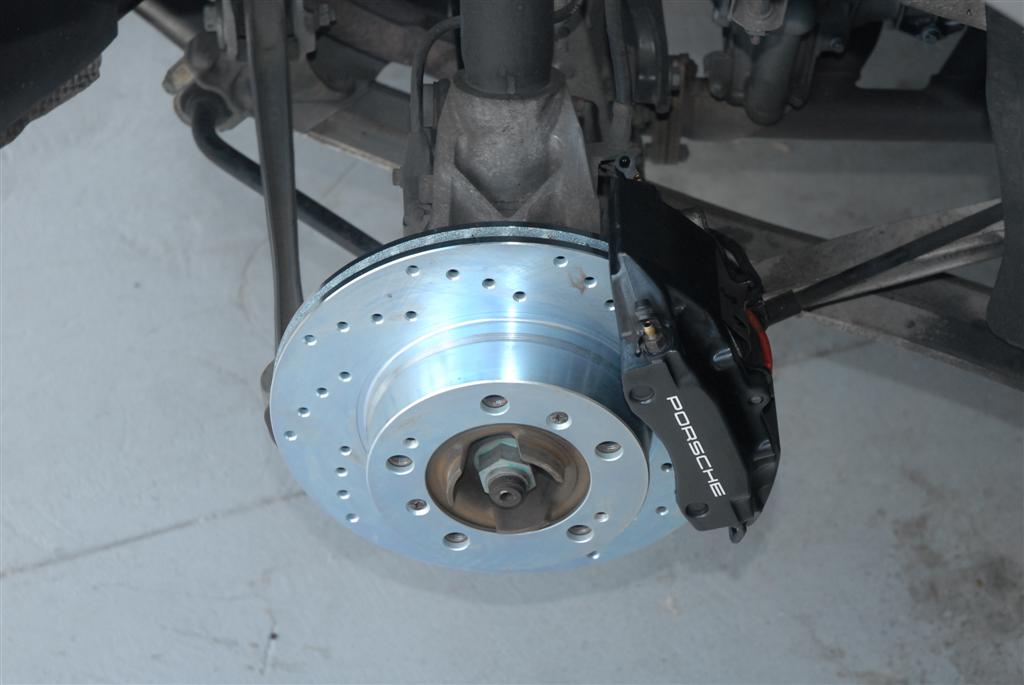

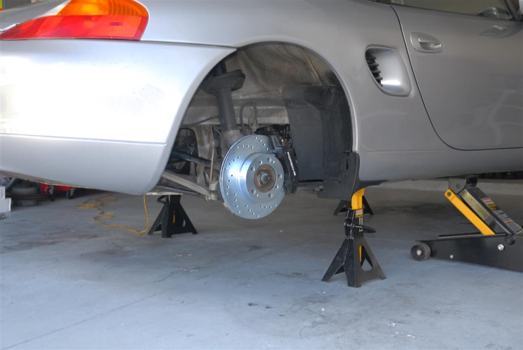

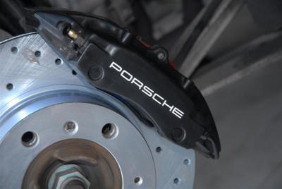

Finally got around to putting new brakes on the car.
New Rotors and Pads and caliper bolts.
Got them on Ebay for $199 plus $80 for the pads. Shipping was $40 OUCH.

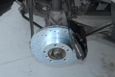

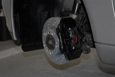

Got all the bits back together. Bleed the brakes etc...
When i turn left i get a clicking sound from the left rear wheel?
*NEW*
Seems some dust? Metal parts? something got into the crack between the brake rotor and the dust shield.
Cleaned it out and i can't hear the noise anymore....The metal parts i figure came from when the brakes
were made i guess!!!
Edited by seafeye
It's more likely a small rock got caught up in the dust shield. It's not an infrequent occurence, but it is kinda worrysome when it happens.
Glad you got it all fixed.
