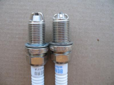

The 1997-1999 2.5 uses a 2 side electrode plug. The gap is .8 mm and it is easy to measure.
The 2000 -2004 2.7/3.2 uses a 4 side electrode plug. The gap is 1.6 mm. I have no clue how you would check the gap on a 4 side electrode plug. If they look ok you just use them out of the box. That is what the mechanics at my local dealer do.
You can see both styles of plugs in the picture.

Sorry to but in. I’d like to have the longest lasting plug that could be considered “stock. I’m going to be supercharging my 99 2.5. Several knowledgeable SC people warned against platinum plugs and advised to stick with “stock” plugs.
Once the SC is installed it's impossible to access the plugs without pulling the blower out, not somthing I want to do to often.
