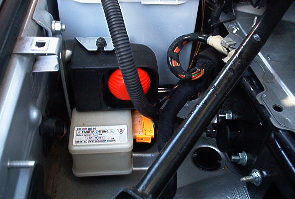

In some countries, like the UK, the alarm also has a tilt sensor. This is to meet the requirements of certain insurance companies.
We do not have this tilt sensor in the US. There is a retrofit kit but I do not know of anyone who has tried to install it. It also comes with an alarm siren with a built-in rechargeable battery. So if someone tries to disable the alarm by disconnecting the main battery the alarm siren goes off.

Looking from the front of the car, it is under the cover to the right of the battery. The siren is the black/red device, and the tilt sensor the white-ish box.
(Photo courtesy of Tool Pants)
There were water penetration problems with the tilt sensor mounted near the battery, therefore is a kit available, sensor and wiring, to move the tilt sensor under the driver seat ( Europe LHD cars)
