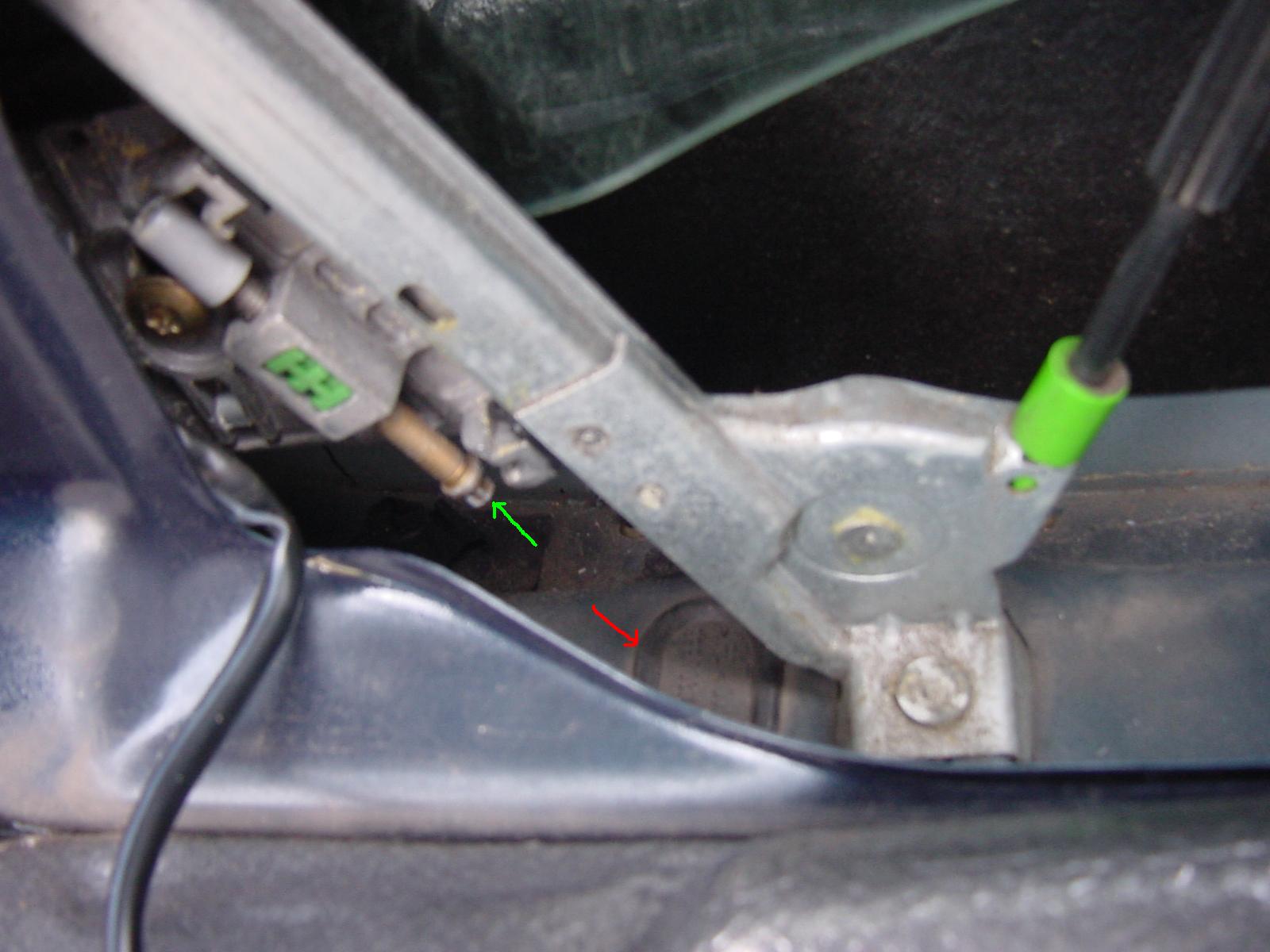

Here are some photos that should help orient you if you are going to attempt the adjustment without removing the door panel:post-6627-1189707901_thumb.jpg
NOTE: The height adjuster screws are not perpendicular to the door sill, rather, they are slanted at an angle similar to the rear edge of the door. The green arrow is pointing to the head of the screw in this photo of the front window regulator rail and clamping jaw.
Here is a photo of the rear window regulator rail and clamping jaw:post-6627-1189708261_thumb.jpg
Again, the green arrow is pointing to the screw. The red arrow is pointing to the black rubber plug that must be removed to access the screw with your torx screwdriver.

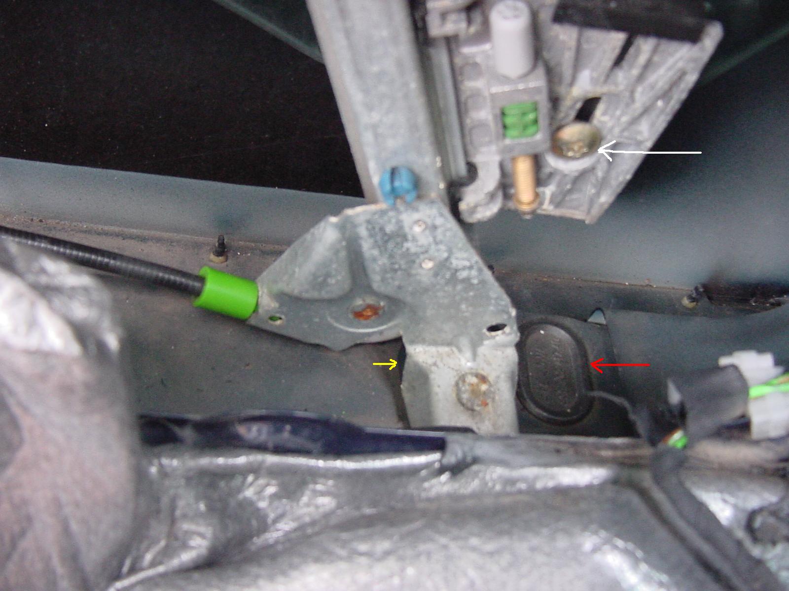

Here is a photo of the front window regulator rail, clamping jaw and rubber plugs at the front of the door:post-6627-1189709196_thumb.jpg
The red arrow is pointing to the black rubber plug at the front that must be removed.
The yellow arrow is pointing to the edge of the "other" black rubber plug which is for accessing the bottom leg of the window regulator rail which is used if removing/replacing the complete regulator assembly.
The white arrow is pointing to the clamping rail screw (in case the adjustment screws don't solve your problem and you should end up removing the door panel).
NOTE: There are four (4) black rubber plugs under the door. The ones you want to remove are the two most outboard ones (as shown by the red arrows), NOT the one shown by the yellow arrow (There is another "yellow arrow" one at the rear that is not in any of the photos..
The correct ones are also closer to the outside door skin.
One last note: To access the adjustment screws, make sure that the window is completely lowered. At that point, each adjustment screw will be about 3 inches away from the access hole. In the last photo, the window has been lowered.

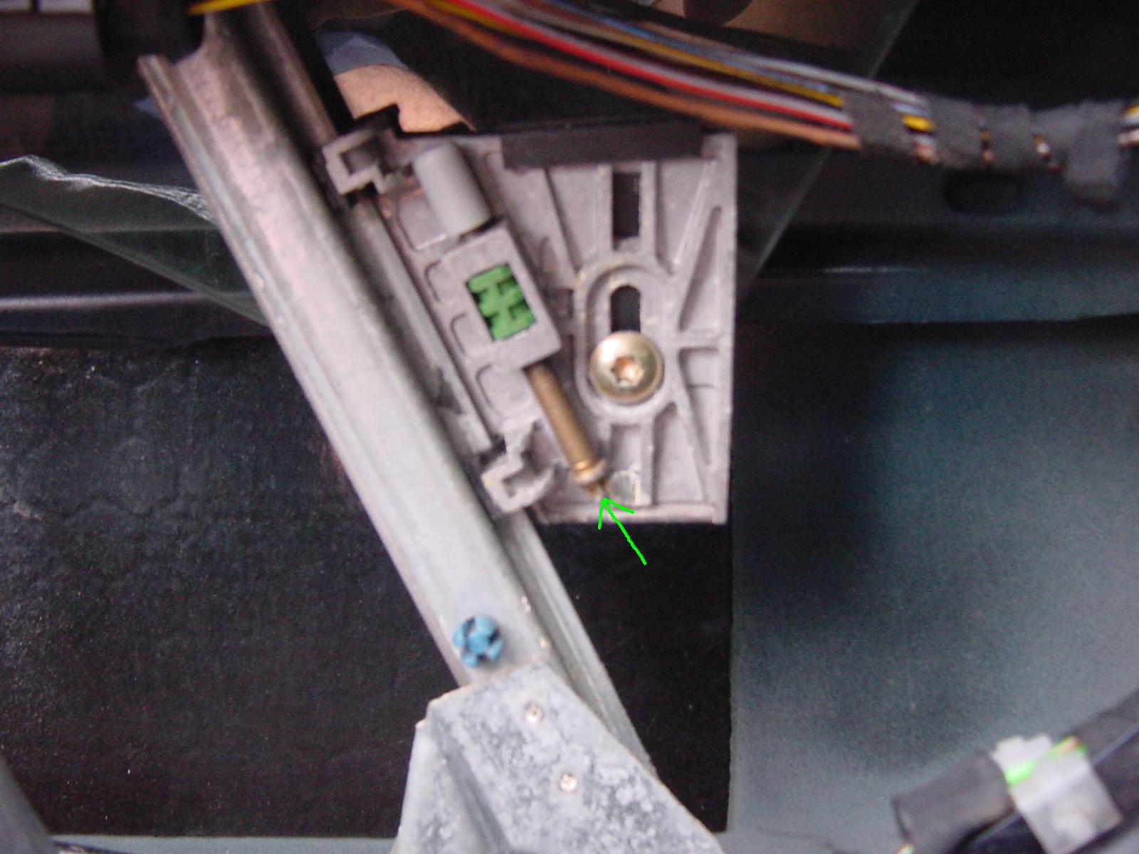

[Edit]
Took the door apart, looks like the rear window clamp was too loose and allowed the window to drop down about 1/3 of an inch. That tilts the window back enough that it was hitting the stationary window at the top when fully up. I raised it up and re-tightened the clamp and it looks good now when closed. There is an even gap of 1/4" from top to bottom.
