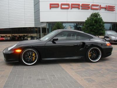

Actually, the car was perfect when i picked it up from Porsche in Dallas. I drove it back 1300miles to Canada -- very carefully. About 3 miles from my house, a gravel truck pulled in front of me and i watched in slow motion as a stone did the jig on my hood...I probably should wait, but it just bothers me everytime i look at it.
