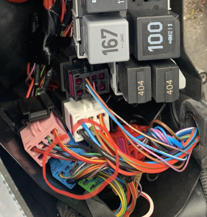

You can buy the stalk separately, it is not exchange. The single wire go's in the electric connector-fuse box in the engine room under the left wiper, i let you know tomorrow in which connector and possition.

The single wire go's in the blue connector pin 3 and in the stalk pin 5. Installing the wire and the stalk is an easy DIY.
Program the DME and STEERING WHEEL ELECTRONICS is a dealer job.

The stalk is still available separately in Belgium, it is even easier for UK ( RHD cars ) to go directly to the DME, which is located in front of the steering wheel in the water drain room, pin A38 grey/yellow wire and make the connection there, if you can find access in the environment of the emergency brake pedal. All you have to do is: buy the original stalk ( 955 613 261 00 ) + pin and screws in the dealership, 1 meter wire 0,35 mm diameter in a shop and you can start. Program is a dealer job.
