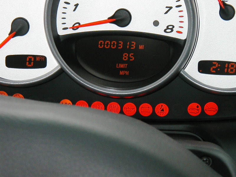

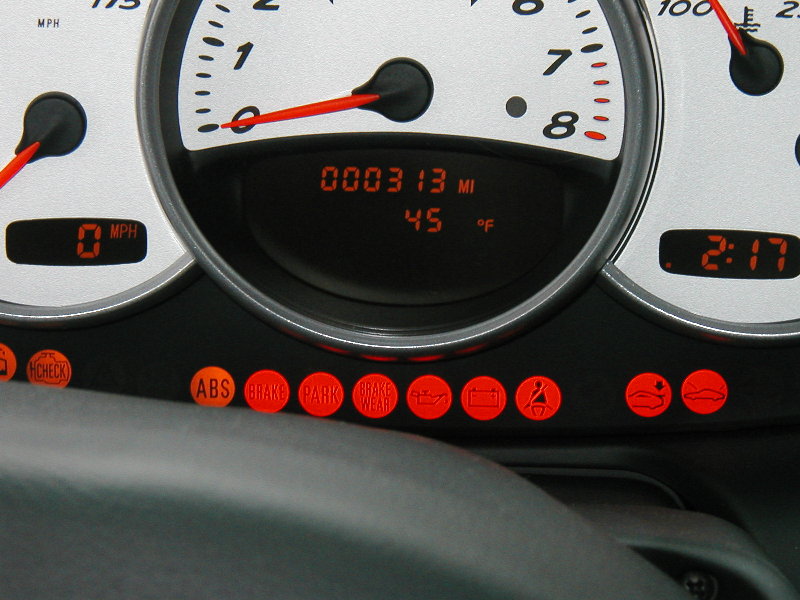

Yes, after the update, everything works. I understand that the OBC on the 2003 will look like the output of a 2000 or 2001 model. I haven’t seen a 2003 with OBC so can’t describe the differences.
A few screen shots for your reference.
Abe
Congrads on the install. Other than the two local 2003s we have done I do not know anyone else who has done the retrofit on a 2003. Others have tried and gave up.
When I see 45 degrees I do not miss the East Coast. But at least the speed gong is set to 85 mph.

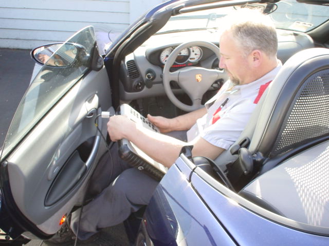

This is the new tester. I did not get to see it in action because Peter was working on a problem Boxster owned by a friend.
