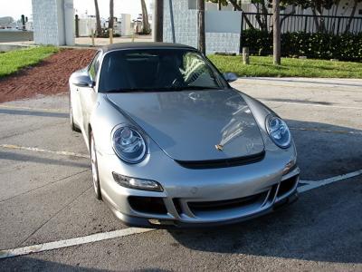

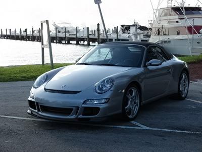

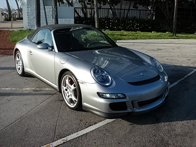

Hello Again.......As promised, here is a before and some after pix of my 997 C4S with its new GT3 front bumper and lip.
You will notice the grill, and also the disapearance of the headlamp washers, I was told that it looks much cleaner without them,
not to mention that in Miami Beach, there is not much need for them. Let me know what you think.....

Looks good not sure if I can get away with lip as I drag mine now when going in and out of certain driveways. How did the engine mods work out?
Thanks...Yeah with the lip you have to be just a little more careful....it is recommended to come in and out of driveways, not facing straight but more like on the side. The cosmetics were just the start, and I actualy droped the car today for the engine modifications. I should have the car ready by this Thursday or Friday as I have added couple other cosmetic touches. Will continue to keep everyone informed as things move along.

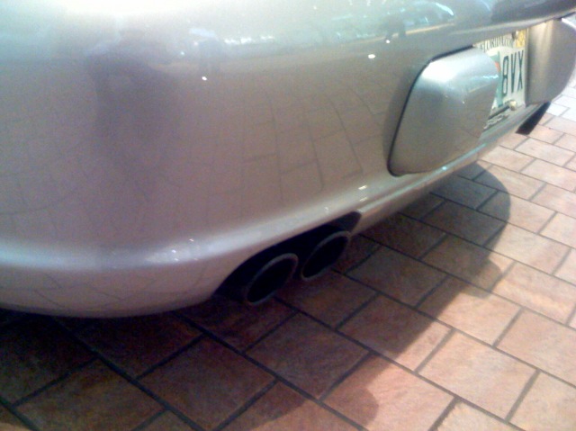

What: Black Ceramic Tail Tips
Why: To Give a nice visual and complement the black hard top.(Also apparently the black ceramic tips get less dirty than the stock ones)

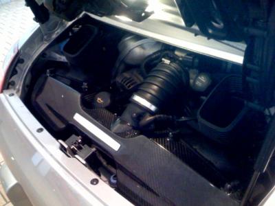

Ok everyone........The car is done.....I saw and heard the results today, but I have not driven the car yet since tomorrow they will load the GIAC software. The Porsche factory X51 intake carbon fiber package looks amazing. I am so happy that I did not go with the EVO intake. Visually the X51 looks amazing. Rich the Master mechanic did an amazing job. He admitted that it took longer to install and adjust than lets say an EVO air box but that the final result is definitely much better. The cost is also higher $1150 plus labor, vs. $595 for the EVO. Now for the muffler music.....I have heard and reheard several exhausts, but the TUBI has clearly impressed me the most...but again it is a matter of preference....so I would not say that in terms of sound one is better than the other. Now as far as the quality, TUBI is impeccable, again possibly amongst the most expensive out there but then again you get what you pay for. When Rich turned the engine on and hit the pedal, it was simply said a great roar that for me combined the combination of powerful presence and yet classy deep notes....I can not wait to open it up tomorrow on the highway. I shifted a little bit with the short shift and it definitely feels more interesting and precise that the previous version...again I will report some more, after driving. The 15mm rear spacers, and 5mm front, made the car look more aggressive and even wider, the lowering suspension spring kits adds to looks and should improve stability.....All in all and so far I like what I saw, I should further confirm if indeed my chosen equation may be the best balanced yet......

I love that airbox, why not do the x51 headers too? So quicker? Is the inlet of the right side bigger? It looks like it from the picture.

Sorry....pertaining to your inlet question, its funny but yes visually on this pix the inlet on the right, seems bigger, but in reality Porsche designed the X51 with the right inlet slightly smaller. Since the distance between the right and left part of the X51 intake is different, this was done to even out the air distribution. When we spoke to the Porsche specialist, he said that Porsche always have a reason and understand why they do what they do. But later I will post some more Pix.
