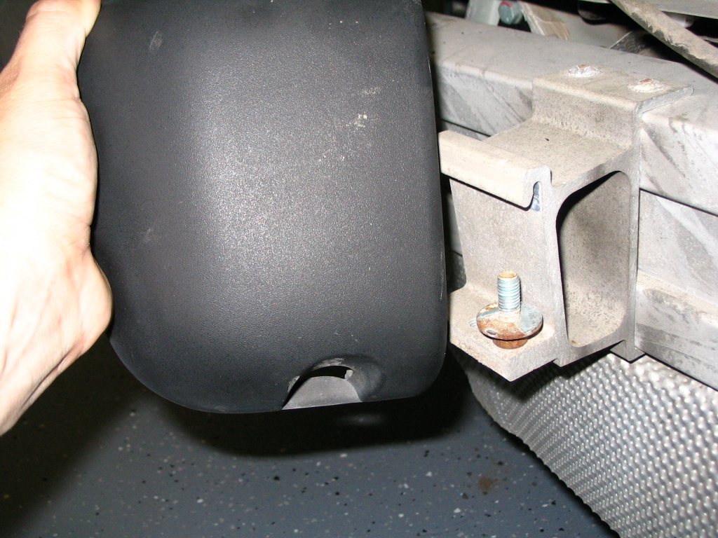

Here are a few pics...
1. a picture of the bumperette removed and the hex bolt and mounting bracket.

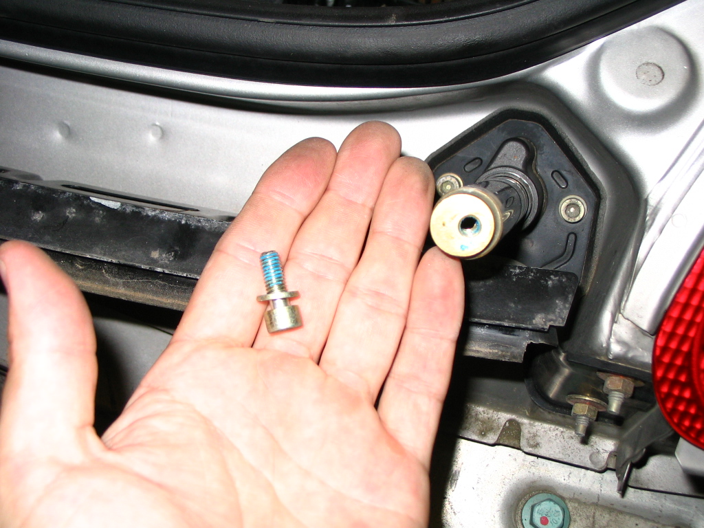

2. a picture of the spoiler with the bracket removed and the hex bolt that holds the spoiler bracket in place.
