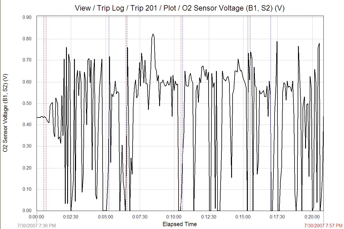

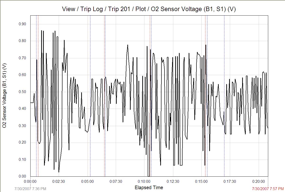

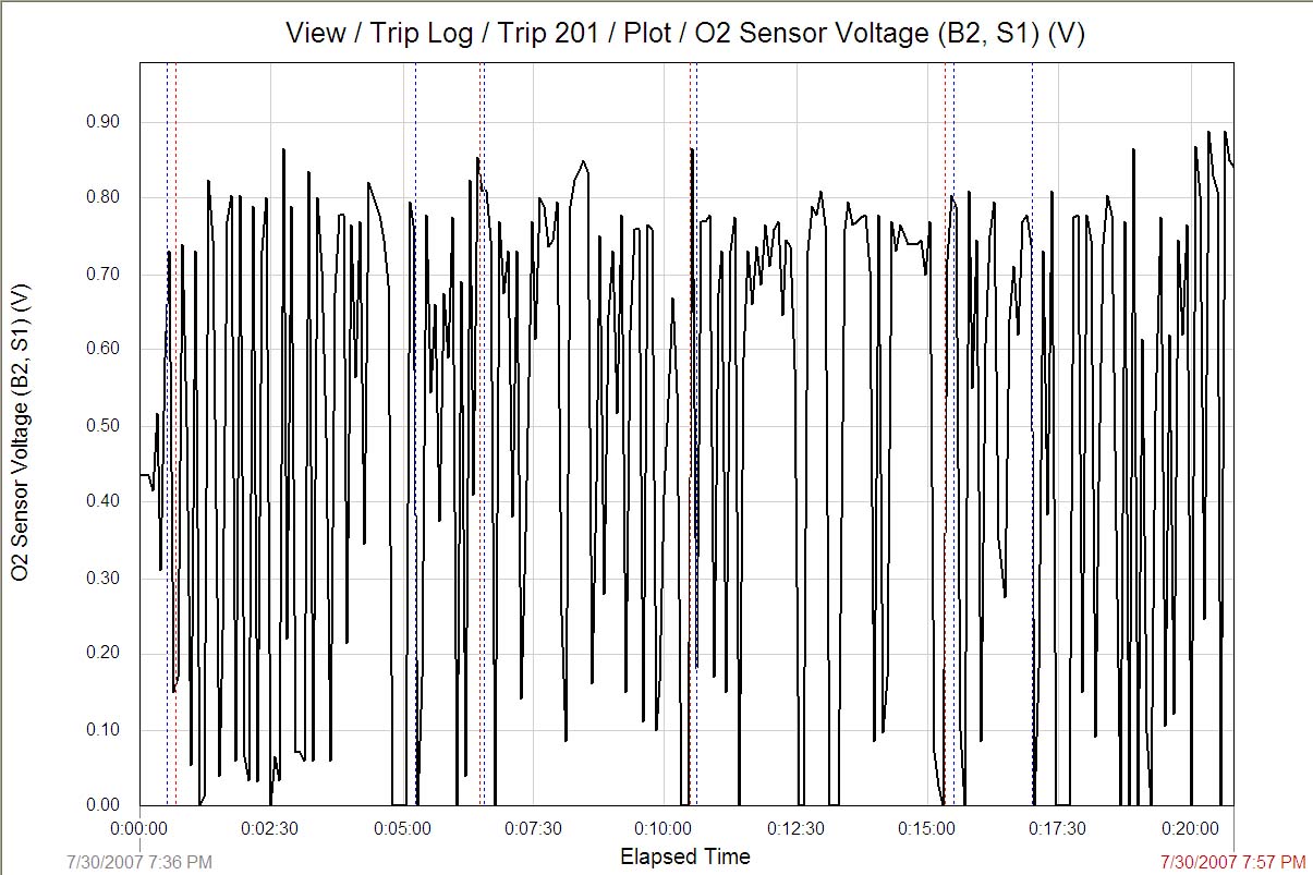

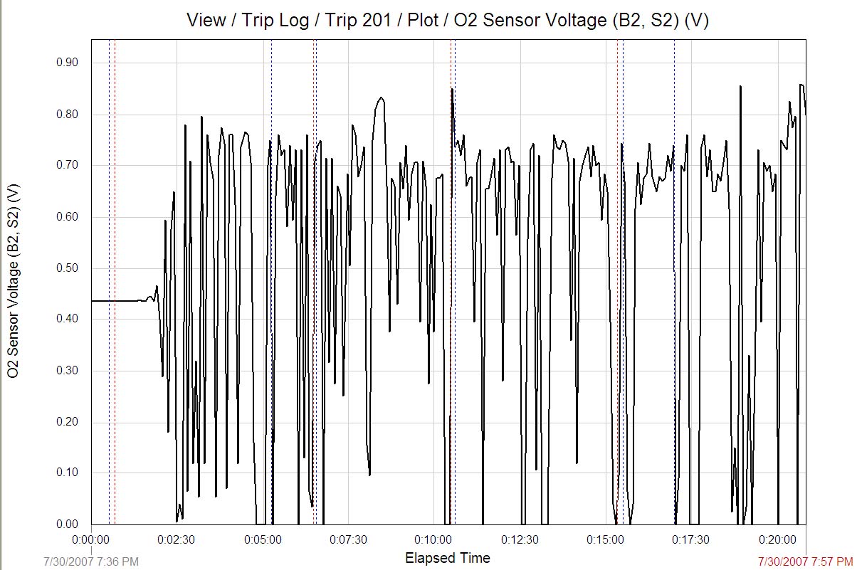

I have reviewed the other threads on this issue and it seems odd to me that I would get misfires on both sides, but only show a possible issue with the B1S1 O2 sensor. The plots also look better than I recall the plot was for the B2S1 O2 sensors that I replaced in the past. I recorded the sensor values for a 20 minutes ride at a variety of speeds. I have attached the sensor plots (5 second scan rate) for your review and would appreciate any comments that could help me resolve this issue.

Most likely causes:
- Fouled, faulty or incorrect
- Contact resistance
- Loose contacts
Have you changed the spark plugs recently?
Correct spark plugs?
You should check the continuity of the flywheel sensor.
Check for cracked ignition coils.
Thanks for the quick reply. I have not changed the spark plugs and that could be the issue. Are your comments following "Most likely causes" about the spark plugs?
If you are sure the spark plugs/coils are good then you need to start looking at other possible causes of the misfires.
Such as a bad flywheel sensor, or bad cam sensor.
I think the spark plugs could be very old as I have not changed the plugs and I have had the car for 3 years. I will search the site for the proper plugs and replace them. I will also look at the other issues you mentioned. Again thank you for the replies and the great support you provide in this forum.
