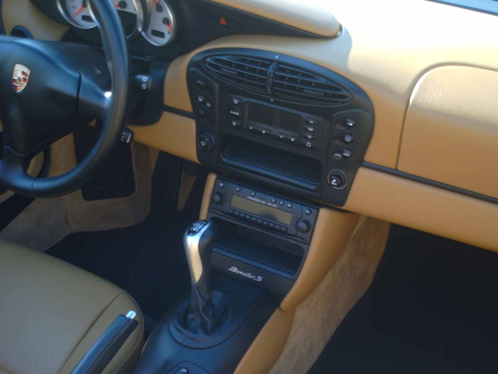

Do you any of you know what kind of fasteners are holding this rack in place? I looked in with amirror and there is no tool that can be used. How is it removed?

Bob, is this the plastic thingy that sits just above your knees under the dash - if so there are 4 screws that attach it to the dash, they are located into plastic push in type pieces, the screws go through the middle of the plastic push ins and expand the plastic like a wall plug.

There are 2 plastic rivets. In the middle of the rivet is a pin. You get a small round tool like the end of a drill bit and push the pin out.
This picture shows a plastic rivet, but the pin has not been pushed in to lock the rivet in place. Your pin will be flush with the head of the rivet and the pin is hard to see for that reason. You cannot pull the pin out so you push it through the body of the rivet.
Quite easy to remove, as Tool Pants stated. Removal was one of the first "mods" I made to my '02 S. In fact, I placed the plastic rivets back in the holes for a very clean look (if you happen to be looking under the dash).
