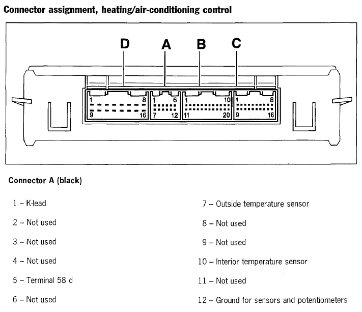

I ran the Durametric code reader and it throws up Fault Code 31: Motor, fresh air-fan voltage too low or voltage too high.
I checked the fuses but could not find one for the motor fresh air fan. Anyone know?
Fault code 31 -- Voltage too low, Voltage too high
Potential causes:
No control module fault stored.
Supply voltage OK.
Nominal blower voltage > 3 volts.
Nominal blower voltage stabilized.
Voltage too low
Note - Voltage too low means that the measured blower voltage lies below the nominal blower voltage.
1. Check the heating activation relay. Battery positive voltage must be present at terminal 87 when the ignition is switched on.
2. Unplug connector C from the heating/air-conditioning control.
3. Connect voltmeter to C 14 (positive) and ground. Switch on ignition.
Display: Battery voltage
4. Push connector C on the heating/air-conditioning control.
5. Connect voltmeter to C 14 (positive) and C 11 (negative). Maximum blower speed
Display: approx. 12 V
Minimum blower speed
Display: approx. 0 V
6. Connect voltmeter to C 14 (positive) and C 16 (negative).
Display: approx. 5 V
Display: approx. 9 V
7. Check driver. Connect voltmeter to positive and pin 3 on driver connector.
Connect voltmeter to positive and pin 1 on driver connector.
Connect voltmeter to positive and pin 2 on the driver connector.
8. Check wiring from heating/air-conditioning control to driver for continuity.
9. Check blower motor.
Voltage too high
Note - A higher blower voltage can only be caused by a short to ground on the wires to pins 1 or 2 of the driver.
1. Unplug connector C from the heating/air-conditioning control.
2. Unplug connector from the driver.
3. Connect ohmmeter to C 16 and ground.
Display: infinite ohms
4. Unplug connector from the fan motor.
5. Connect ohmmeter to driver connector pin 2 and ground.
