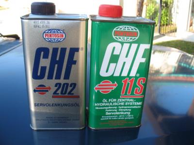

As for your power steering refill need, just look at this link. It shows you the way to get to your engine to view the power steering cap where you can fill the fluid. On the last picture, the power steering fluid cap is the one right behind the drivers seat back. Make sure you buy the right fluid, and when you refill, don't fill too much- the reservoir is small. Add a little at a time. It's Pentosin brand CHF 11S. It looks like this: chf.jpg

If you need more you can use the stuff in the silver or green can.
