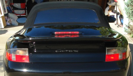

If you can swing it, I think it's the way to go. The guys who did my top gave me a few options. They offered to replace the plastic with (a) this new polymer that doesn't scratch as easily and (2) sew it into the canvas rather than glue it, as had been done at the factory. This should prolong the life but since my canvas was already pretty worn I opted for glass.
Here's some pics...

Old window was 36x16 .... new glass one is 35.5 x 12. How badly do you miss those extra 4 inches of height?
Where does the wiring harness attach, and where do you install the new switch to turn the rear defogger on and off Are there already extra harness plugs and operation "button holes" on the car?
Any worries about the heating element making the glass hot and over time weakening the glue bond between the glass and the canvass, putting you back to square one needing replacement again? Or is there a more high tech bond than just glue?
How long has your new top been installed and can you offer any additional comments about how well it operates and if any problems have cropped up?
I'd be lying if I said that I didn't miss the height. There's not as much visibility out the back but (a) I keep my top down almost all the time and (B) it's primarily lost in the height and not the width. So while driving I don't really notice at all. I am more careful when backing up now though.
Having said that, it's glass! When I was backing up before, all I could see was blurry blobs out of my hazy plastic. Now, I have glass...
No worries about glue because this top is double stitched. You can't see it in my pics but check this one out: http://www.gahh.com/PHOTOGALLERY/996-glass3.jpg
Also, this top has a 3-year mfg warranty.
As for the defroster, I actually didn't want it. The installer said that it comes with it and I got no discount by turning it down, so he went ahead. I asked the same question: "Where is the button going to go?" He pointed to my dash and demonstrated to me that I already had the button in my "horseshoe". I guess they are there by default to work with the hardtop? In any case, not an issue. The only extra part was the wiring harness and they hooked it up as part of the install.
I have not had the new top long enough to know about any issues. (2 weeks.) In the first two weeks, you cannot put the top down at all. The canvas needs time to stretch. I will take the car back next week and they'll fine tune all the adjustments. My installer warranties all the mechanics of the top. (Not the canvas but the actual mechanical top, since they had to take it apart). So if anything breaks or rattles or falls apart, they will fix it, no questions asked. It's like an extended warranty for my top...
That's about all I know. You might try contacting GAHH and asking if they have recommended installers in your area. Or call the dealer and ask them where they outsource their cabrio work.
Let me know if you have other questions.
