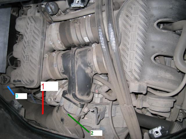

Hi guys, I opened the engine again to take some pics and I tried to get the TB out once more.
In the picture below I loosened the hose clamp in blue, number 3 (the screw popped out and got lost in the open parking lot and I had to replace it with a generic, PepBoys clamp). Then I loosened the other hose clamp - number 2. After all this I could not move the tube a single inch from the TB, but the number 3 end came out easily. Should I just keep on pulling the end close to the TB or is there an easier way to do this? Can I cause any damage by pulling hard...

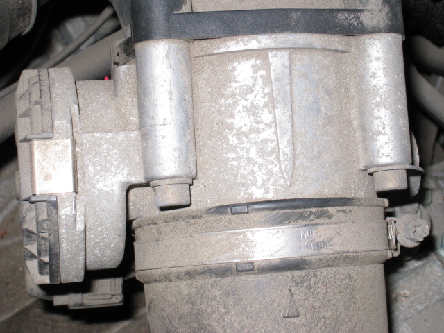

I also added a second picture just to show how dirty the Throttle is on the outside... I really need this cleaning.

I just cleaned the throttle body for the first time on my '01 2.7 this past weekend (yesterday - Sunday). Despite all the discussion on this in the past, I had trouble searching for the procedure for getting to the throttle body and removing it. Here's what I did:
Loosened the hose clamps on both ends of the plastic tube [1 in your first picture] running from just past the MAF / air filter box [3] to the throttle body [2]. As you noted, the end [3] that butts up to the MAF comes off pretty easily. The other end that joins the throttle body i[2] s a real pain to get off. I pulled, twisted and wiggled for about 30 minutes, and somehow just got the right combination of moves and it finally came off. My hands aren't that large, but my knuckles are pretty beat up. I found it's easiest to access from the driver's rear fender side. Don't worry about the trouble getting it off, because it's even harder to get back on!
I don't think it's possible to get the throttle body off without disconnecting the plastic tube at [2], but if there is, it would probably save half an hour or so. Same comment applies to reassembly.
I haven't read about anyone using a blow dryer to heat up the plastic tube at [2] to expand it to get it on and off easier. I was going to try that if all else failed after a few hours. Somehow, the plastic tube just came off after struggling for a while.
Once the black plastic tube is off, pull it out and set it aside. It was clean on the inside, but I wiped the outside down with several rounds of Simple Green, followed with water to get the Simple Green residue off. The throttle body comes off by unscrewing the 4 long bolts with a metric hex driver. The 2 long bolts on the driver's side have washers, and the 2 on the passenger side do not. Once you have the 4 bolts off, the throttle body is still connected with an electrical connector (e-Gas models), which simply unplugs. Pay attention to the orientation of everything. You'll notice on the throttle body there's an arrow that lines up with an arrow on the plastic air tube (visible in your second photo).
Cleaning the throttle body is the easy part. Just keep spraying throttle body cleaner and wiping the crud off. You can push the flap open to get all the way through - it's spring loaded so watch your fingers. I also tried wiping down the tubing on the back side of the throttle body, but it was pretty clean inside (at 51K miles).
The only hard part (as you would expect) is getting the plastic pipe [1] back onto the throttle body [2] after the throttle body is reattached. Expect another 30+ minutes of pushing, twisting, wiggling, swearing, etc. I lightly sprayed some silicon spray on a paper towel, then wiped it on the outside of the throttle body and inside of the plastic pipe. Hard to tell if it helped or not, but it didn't hurt. After everything is put back together, start you car and make sure everything runs and the throttle works before closing everything up.
When I was all done, I gently re-tightened all the hose clamps since several felt semi-loose
I don't think it matters how dirty the throttle body is on the outside for how your car runs! It's the inside that counts. But there's no reason not to clean up the outside when you have the throttle body out

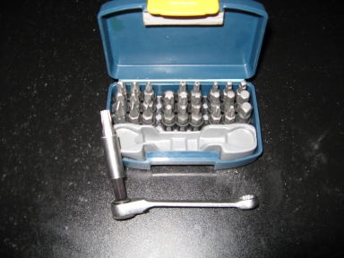

This works like a charm to remove the 4 bolts holding the TB. It's just over 3" long.
As for getting the Tube from the box to the TB off, it helped having the car warm to remove it and I found having a third hand was a snap to pop that sucker back onto the TB.

Jim:
What brand of tool is that? Is it available on the internet?
Regards, Maurice.
Maurice,
It's a Mastercraft set sold by Canadian Tire (up here north of the 49th :) ). I've never looked but I would think that you could find a similar set or even more of a complete set (a bigger range of bits) online. I would google "torx security bits". As a side note. I would avoid non-brand named stuff. Sloppy toleranced stuff can lead to rounded slots in the bolt head. Not fun considering how tight the work area is.
Jim
