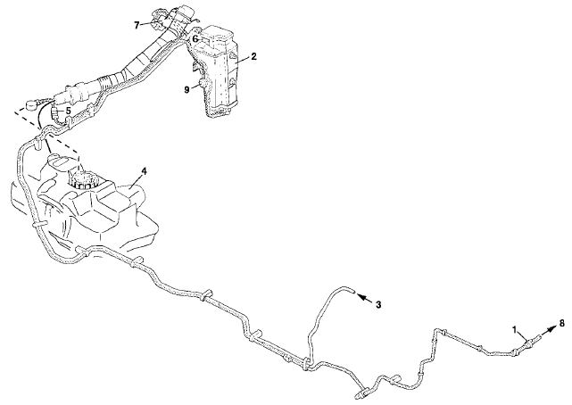

Okay, after clearing the P0452 CEL multiple times I finally purschased the tank pressure sensor to fix this. However, I have no clue how to install it... Does anyone have any information on where this sensor is located and how to get to it? I believe the dealer said it was on top of the gas tank next to the sending unit. Is that under the battery tray? Thanks,
David
MY99 Fuel Tank Ventilation System
1 - EVAP canister purge valve
2 - EVAP canister
3 - Purge air
4 - Tank
5 - Tank pressure sensor
6 - Shutoff valve
7 - Operating purge valve
8 - To intake manifold
9 - Vacuum control valve
Okay, don't shoot me... but this is the same drawing I got from Porsche when I picked up the part... but it does not really show me where the sensor is in relation to the car itself. They thought it might be in the area of the battery but their techs have not done a replacement of this part before so they could not verify. Is there any better picture or service procedure that shows the replacement process better? Sorry to be such a nitpicker on this... ;) :renntech:
David

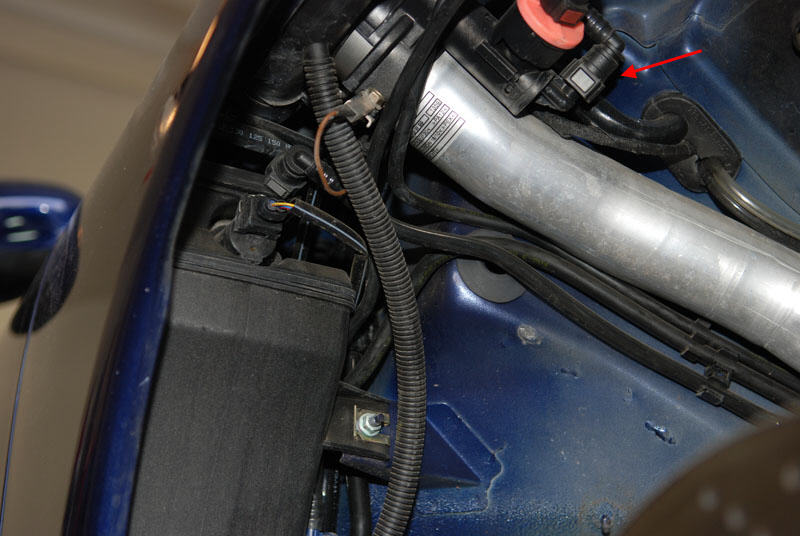

Pull off the wheelwell liner on the front right and you'll see the evap cannister beneath the gas filler tube.
You are da man!!! I guess Porsche was wrong, its behind the wheel liner. Will check it tonight and hopefully replace the darn thing! Thanks again! :renntech:
David
I think this is it.
To see how to get to this point have a look at Replacing the Gas Door Actuator here.

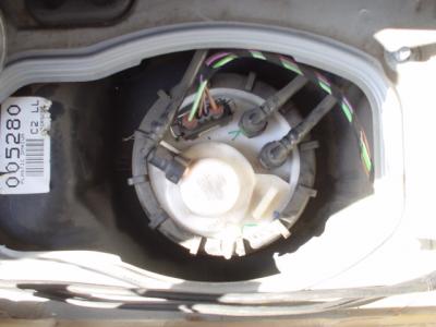

Picture of the top of the gas tank next to the sending unit on my 1997 Boxster. Battery tray removed for the picture.
No sensor there - but I have a 1997 and I don't think 1997 had this sensor.
But if the part you need to replace is #5 in the diagram I do not think it would not be under the battery tray.
Shoot, so it may still be under the battery... guess I will just have to start tearing the car apart and looking for this thing. ;)
David
David
