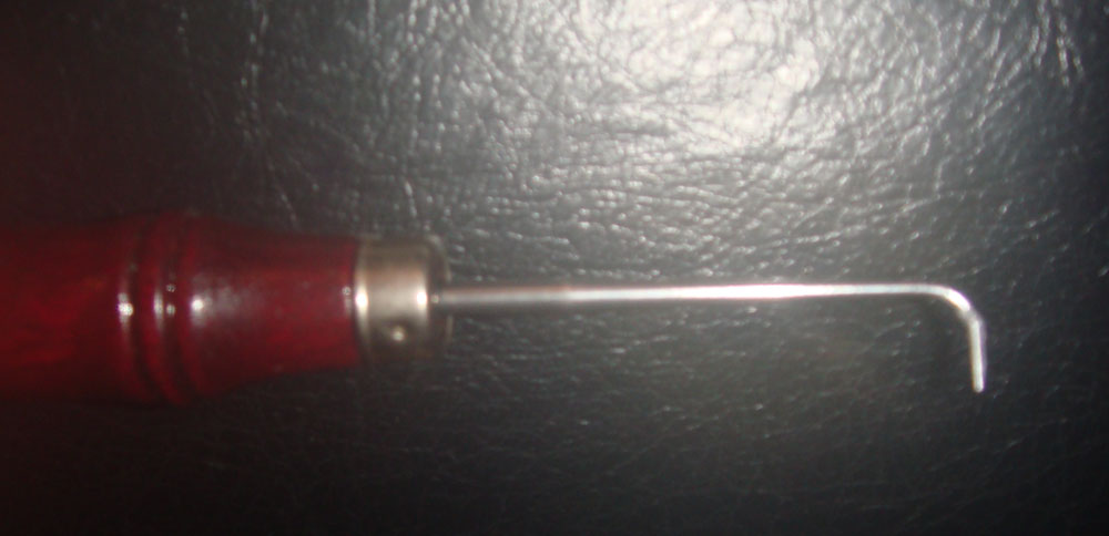

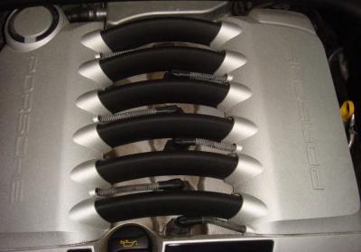

I changed the plugs today and wanted to offer some advice. To remove the ignition modules you need to get AWL and bend the tip at a 90 degree angle. Then all you do is insert it into the locking clip and pull up slightly. Then the entire module just slides out without any force. In fact if you are using to much force to pull up on the locking clip you are doing something wrong. Its very simple with very little force.
See attached pictures.
Edited by 97boxsterred

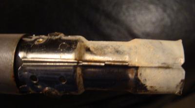

On the ignition coil closest to the windshield, there was all this white residue while all the other ignition coils where clean (silver color). Does anyone know what this means?

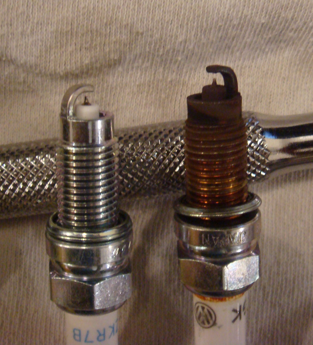

Please see attached pictures. There is also a pic of new versus old spark plugs that have 55K miles on them.
The white residue on the coil is oxidation, look for water infiltration and replace the coil.
Let the connectors stay in place on the coils, no need to remove to pull out the coils ( V6 ), much easier.
