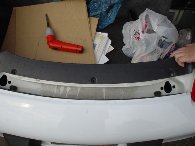

You need to review the install instructions. The spoiler is removed and the plug to the motor is disconnected. A black plastic trim plate in the kit covers the hole - you can see the plate has been removed in this picture. Then the bulb in the instrument cluster for the spoiler warning light is removed.
