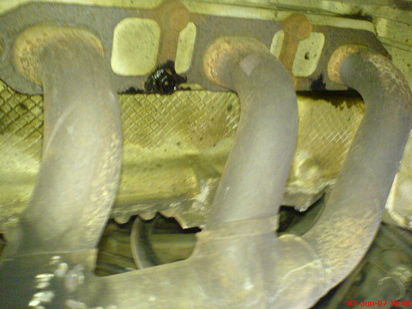

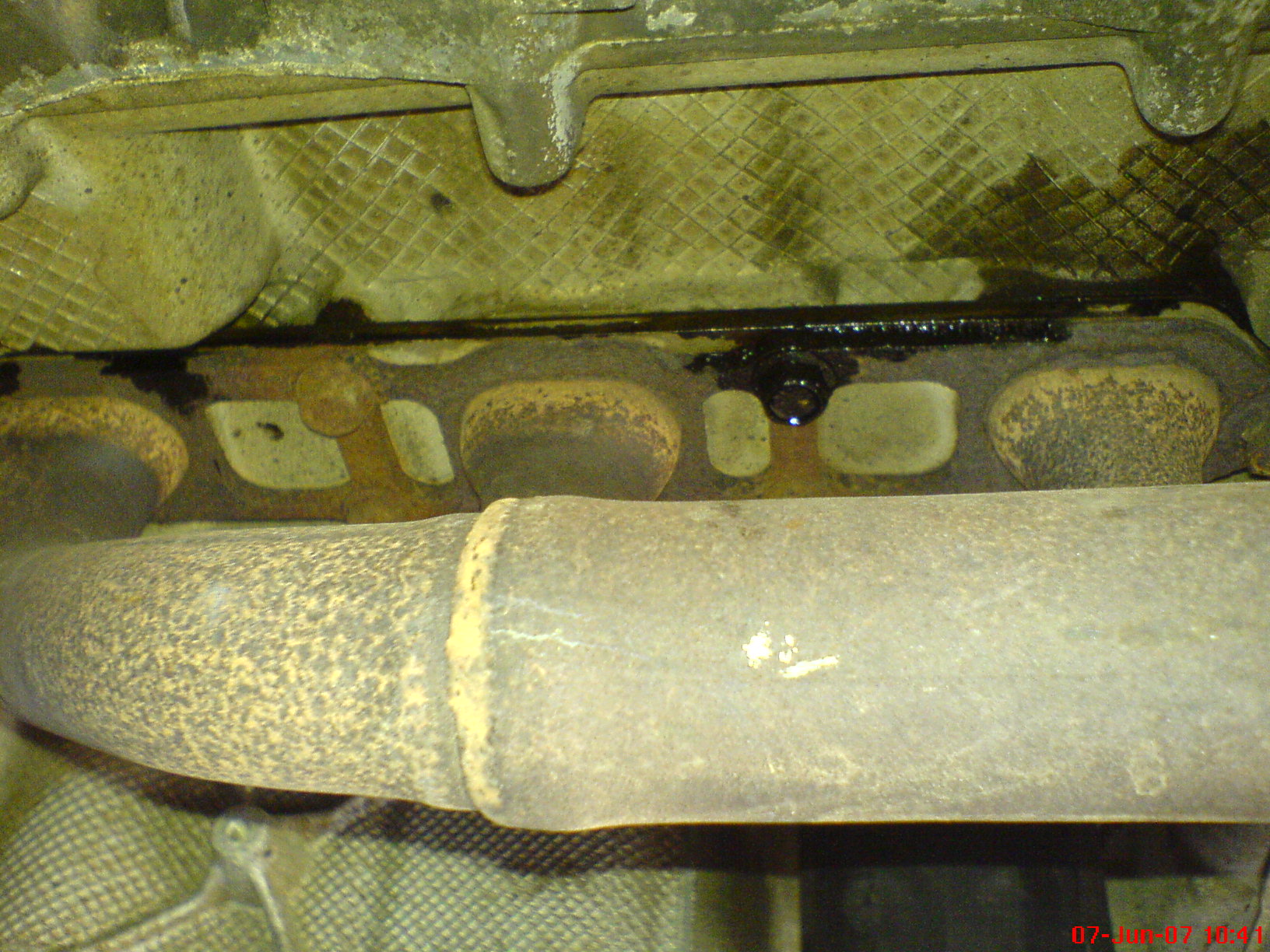

I have a 1999 Boxster 2500cc and I every time I start the engine a lot of white smoke comes out from the excausts for approximately 5 min.I made a search in forums and many people says that if I change the oil separator it will be ok.I went to a car engineer and we notice that there is oil leaking in the left excaust headers.I will put some pictures below.I ve already order the AOS but the engineer believes that this will not correct my problem.I asked him what do you think is the problem then?And he told me that he dont know what the problem is,maybe I need new engine.

not sure that would be the oil separator. I have seen the results of one letting go and that is not what it looks like. When was you last oil change? What does your oil level read first thing in the morning with all the oil drained into the sump?
I have change the oil 2 weeks ago and it looks ok every morning.I have some oil leaking but this is come from the oil separator tube(photo below).But the oil at the escaust headers is really strange.Engine is working properly.Temperature is ok.I really dont know what problem is :(

I would drain the oil and look for coolant in the oil. If there is none then you still need to find the source of your leak. You are going to need find someone that can at least do that. For all you know someone spilled oil on the engine and it is slowly dripping down.
