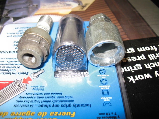

Best option I could think of are those horrible infomercials for Gator Grip. http://www.endeavorproducts.com/ggrip/ggrip.html

The problem is there are many possible sockets, so they may not be thrilled to do it. If you are desperate you might try those damaged bolt sockets that bite into the head. I highly doubt that Gator thing would work because lugs are probably torqued to at least 75ft/lbs.

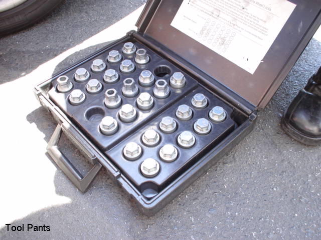

As stated, take it to the dealer. They have a set of all 30.

At the hardware store today I looked at the gator grip. There was only one size. Model ETC-120 that is 1/4"-3/4" or 7mm-19mm. This one is too small to fit over the head of a locking wheel bolt.
The website shows a model ETC-125 called the king gator. The range on that one is 12mm-32mm. The head of a locking wheel bolt is about 25mm. So....?
Wish I could get my hands on a ETC-125 to see if it would work.
I got my hands on a King Gator. It's too large to fit inside the well to get at the lug nut.

i went to the dealer and they told me that they don't make sockets that i have anymore and wanted me to buy a new set for 145 dollars. idiots. i still cant remove the ones that are on the car couse the socket is bad.
ordered new set on ebay for 12 bux, including the locking one, and socket. but i went to a random shop down the street and a guy took them off for me in 5 mins

I had the same experience with my wheel locks. The dealer wanted to replace all lugs. The I went to the Local tire store and the kid working there took them off for me. (I tipped him 10 bucks.)
