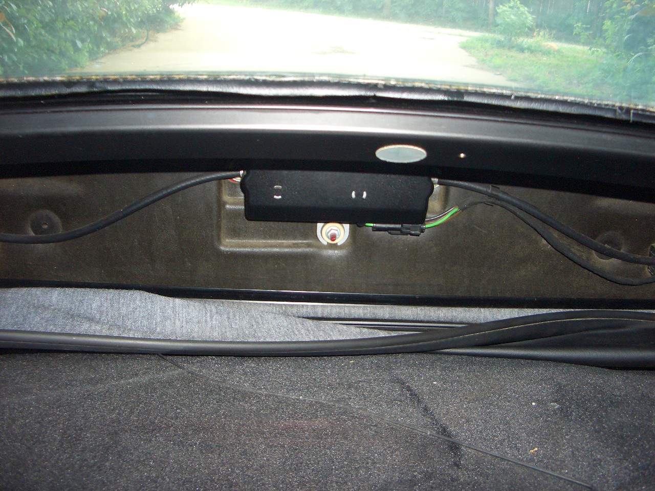

Thank you guys for your help, I really appreciate the info so far. It was really frustrating me today so I went and took off the vinyl cover to reveal where the noise was coming from. I'm assuming that the black box in the first picture is the motor for the top? Well when I push the "open" button to put the top down, the cables coming out of the driver side of the box (the one where the green line is attached) move up and down and that is where the ticking is coming from. The single cable coming out of the passenger side doesnt seem to make any noise or movement. I tried moving the cables around to where ever they attach at the motor and they move around a bit but still nothing worked. Sooo - I guess I will try and do the cable thing myself, if that's what everyone thinks it is after this post.

yes, that is the conv top cable motor. there is a brass clip on each side that holds the cables into the motor. slide out that brass clip and pull out the cable(s). you will see the thinner drive cable sticking out the end. the length sticking out the end should be 3/4". if it's shorter than that, that would explain why your top isn't working, as the motor doesn't have enough drive cable to grab on to to turn the transmissions which in turn move the clamshell up/down and the top frame open/closed.
