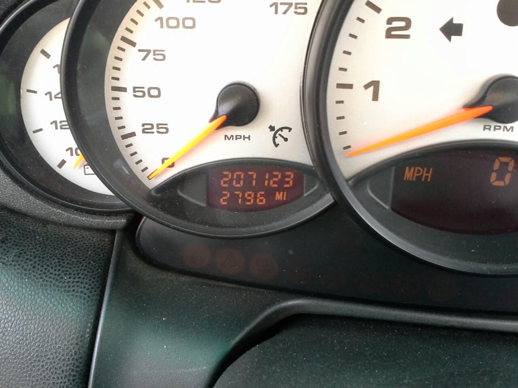

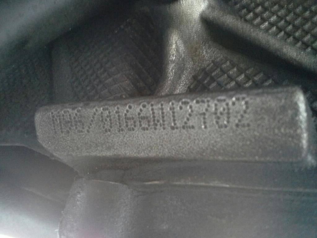

Just bought a 99 Cabrio with 207k on it.  It runs great!  Looks like its the original engine (M96/0166W12702).  I could not tell you if its ever had any major work done or anything though.
Pics below
Edited by lt1buick
