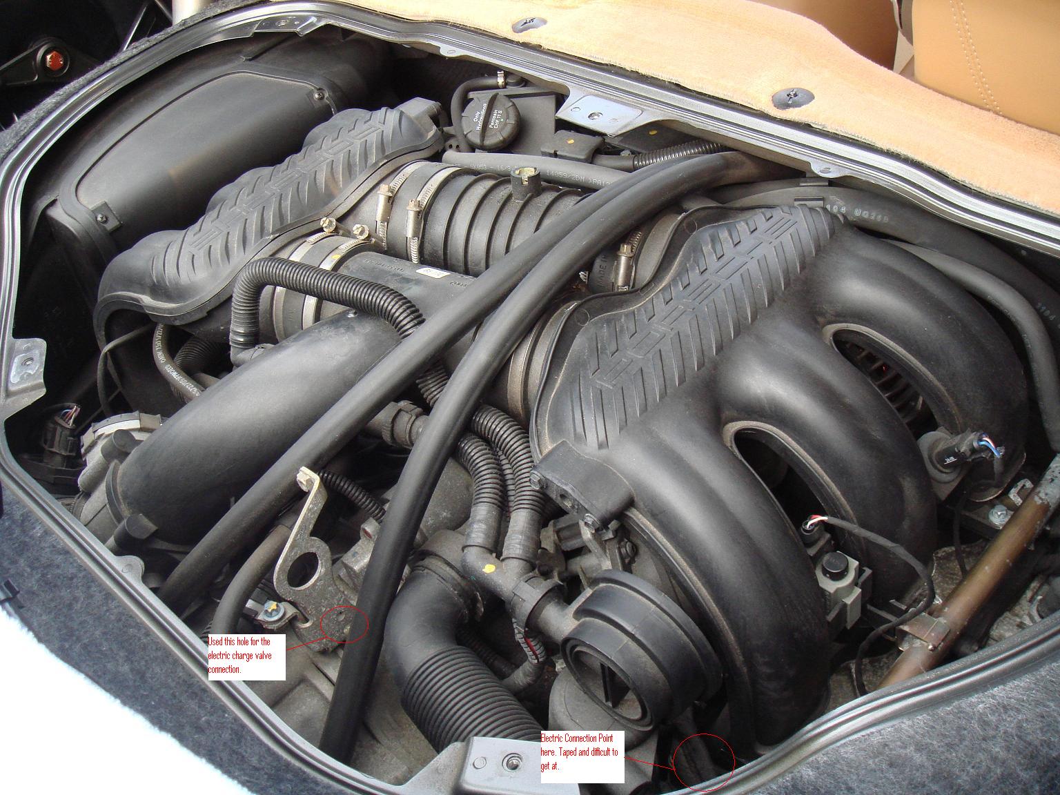

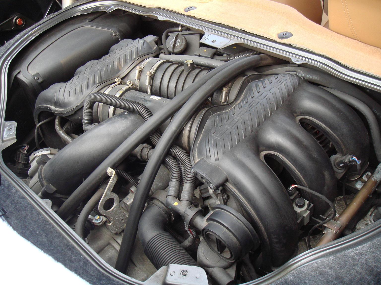

Since i last post on this, i've had the chance to open up the engine bay and take a peek around for the neccessary lines.
I've found that there is indeed a standard change-over valve (where you connect into the vaccum system) however located between cylinders 2-3 as opposed to 1-2 in the TSB. Removing it, it's very likely that you can plumb into to get a vaccum line to the electric change-over valve as part of the PSE kit.
The only trouble i noticed was that i couldn't find the 2-pin harness that was meant to be connected to a dummy block found underneath the scavenge pump. It's this cable that connects to the electric change-over valve. Also, the change-over valve is meant to be connected to a lower point on the engine hoist as per the TSB again, but the space is already occupied by a large breather pipe.
I'll try and upload those photos i took of my MY06 987s.
Regards
Popolou
Here's the snap i took of the engine bay when i was investigating whether the neccessary gubbins were there for the PSE: -
As you can see, the standard change-over valve is located between cylinders 2/3 and the 2-pin harness thats meant to be behind the RHS branch of the intake manifold isn't there (at least, i couldn't find it). I suspect, and if wizard263789 wants to come back to me on this, it could be very well hidden down there so its possible that it may exist, but i couldn't spot it.
Towards the back, you'll see that the lifting eye already has a hose attached to it. According to the TSB, that (occupied) screw hole is meant to support the electric change-over valve. It therefore seems that there are a number of differences between the 3.2 and 3.4 blocks beyond merely capacity.
My car is in for a little recall work but will confirm with them that there is no PSE option within the DME for a MY06 car. If that's the case then it should put to rest the issue of anything prior to an MY07 car going for the full install of the the PSE (DME and all) but, and as already posted, you shouldn't have any trouble installing the mechanicals and leaving out the vaccum lines.

Ok. For those interested I have re-attached Popolou picture with the location of the cable connector and also the electric charge valve connection point, as Popolou has said the the standard valve is also between cylinders 1 and 2 on a MY07 engine.
