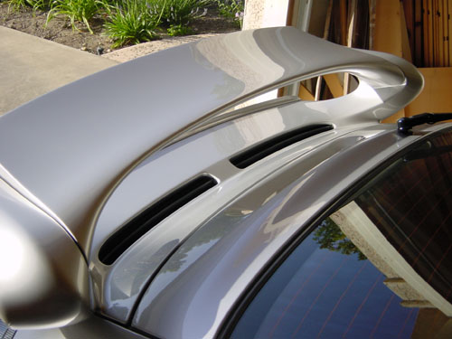

... my aerokit spoiler is in the middle position ;)
(not the best pic but you get the idea)
Hello Loren, I believe this is the mk1 aero wing but will this aero wing fit on a 2002 Carrera coupe? I have never seen this particular wing on a 2002-2004 model.
Technically it looks like it will fit any narrow body 996 (no C4S). The matching front bumper will not fit a MY02 and car because the headlight and fender openings changed.
