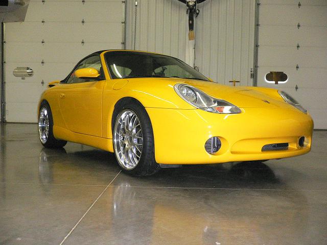

I was at a local porsche dealer the other day to grab the latest Nord Stern newsletter and a salesman pulled me aside to tell me that my car is very unsafe with its current configuration. He explained that the rear spoiler with the absense of a front spoiler will cause the front to get very light at speeds over 90mph. For the record, he was pretty nice about the explanation. I doubt he expected me to trade it in for a different car right then and there.
Anyway, I agree in principle that he may be correct. But am I the only one with this type of set-up?
And is he right? I plan to do some driver training at BIR next month, so I'm concerned about the set-up.

Why then is my exact set-up shown on the Strosek website? Is it pure negligence on their part? They claim that my front end "reduces lift on front axle".

This car has a complete Strosek body kit - front bumper cover, side skirts, rear spoiler and diffuser. Strosek, like the other major Porsche tuners - Ruf, Gembella, and Techart, performs wind tunnel tests on their designs and their product results certainly show that Porsche's "40+ years" of development can still be improved upon. Strosek has been around a long time. If, in reference to this front skirt, Strosek's website says that it "reduces lift on the front axle" (and it does say this: www.strosek.de), I'm inclined to give them the benefit of doubt - much more than some salesman who doesn't even recognize the fact that a completely redesigned bumper cover plays a factor in the equation.
Bottom line, I don't have a definitive answer but, unless someone backs up their statements with actual evidence to the contrary, I'm more than inclined to think the car is just fine. I certainly wouldn't go so far as to call it "very unsafe".
E-mail Strosek at the site I listed above and see what they have to say. That's the best answer - as opposed to a bunch of wild speculation and hearsay.

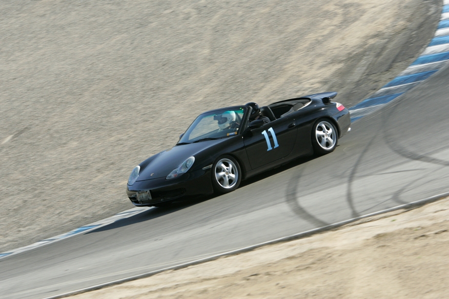

I also have a Strosek rear spoiler just like yours, except that my spoiler is only the main lower section, not the full two-layer spoiler that you have. I purchased mine through Fred Opert Racing in New Jersey, an authorized dealer for Strosek parts. They told me that I could install the main spoiler body without modifying the front end, but not the additional second level like you have. I have installed the rear main Strosek spoiler and I can confirm that even with the single-level wing, the front end did get a little lighter.
For part of my drive to work every day for the last six years, I had a fairly straight section of highway that is pretty much impossible for police to patrol, it is two lanes each way with a concrete divider and guardrails, and downhill when on your way to town. I typically reached between 80mph to 110mph most days on this stretch depending on the amount of traffic. At 110mph, the front end is uncomfortably light, almost spongy/springy. My personal max speed in this car is 145mph, but that was on a section with no turns. Again, it was not comfortable, I knew the car was technically capable of more but did not want to try it. Prior to installing the wing I did not feel this level of discomfort at high speeds. I had our Boxster up to 140mph and felt like I was fairly stable compared to the 911.
I also tracked this car (with just the Strosek rear wing) this year at Laguna-Seca, but the top was down the entire day and I never reached more than 110mph on the main stretch so aero wasn't too much of a factor for me there. The balance of the car felt very good even at reasonably high speeds through the corners in turns 4-7. My 996 is not lowered, I have the factory springs, but you can see that it drops pretty low through the corners anyway.
I definitely think it's not as safe in this configuration, but it looks a lot cooler (subjective, I'm sure), and I haven't been so worried about the imbalance that I felt compelled enough to spend money to change the front end. However, since you have the second level of this spoiler your car probably experiences more downforce than mine.
