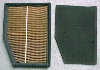

There are 2 metal clips on the side. Push them out and then slide the tray out. It will slide out in two stages (like rollers on a cabinet drawer) which just the cover and plastic first and then the filter slides out in part 2. Easy to do. Box is on the left side of the car shown here in top of picture (rectangular box with label on it)
Remove old filter. Suggest you also vacuum down inside the air filter box (use and extension to get way down in there). Drop in new engine air filter. Slide closed and re-fasten clips.
Will take you 2min at most once you have the engine bay opened up.
Once you get the filter out you remove the black layer of foam.

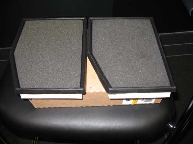

Doesn't the new filter usually come with the foam?

It probably will get dirty quicker but i think its main purpose is to reduce sound.
Most aftermarket filters designed for 986 don't come with the foam anyway.

This is true. Aftermarket oiled filters such as BMC and K&N do not have a layer of foam. Some people who put them in think they have more power because the induction sound is louder. The 996 series cars do not have a layer of foam because their intakes are in the rear of the car. On the other hand the intake on a Boxster is right next to your left ear.
