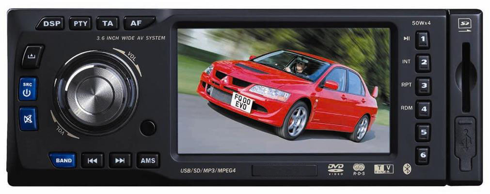

Ok, gentleman!!
Here is one for you. I was not so fortunate with my installation. It seems that the wiring goes straight to the amp and then gets routed to the individual speakers. However, I have a 4x50W radio that seems to almost not need the amp. This is weird, but one I connect just 1 position wire speaker to the wiring of the Porsche I can already hear the radio. Also, I am getting a slight feedback hissing sound.
I would ideally like to route the wiring direct to the speakers since I dont think this radio needs the amp. Loren, anyone, please help me out with some suggestions.
It seems as the negatives for each wire leads into one wire which then goes to the Porsche harness. This is such a weird setup. I need to run individual wiring from the radio to the front where the amp is. How do I get through the wall to run the wiring?

this is what i did to make things easy for myself....i ran 4 sets speaker wires to the wiring harness of the stock amp that led to each of the speakers....i disconnected the amp up front and put it in storage....i did not cut the wiring harness just tapped the wires with t-taps and went straight to those wires....hiss is usually from a bad ground but you shouldn't have a hiss if you're not running an amp from you headunit...easy way to run wires is on drivers side....look at the corner on left side under the hood and you'll see a black cover with two screws-one in front and one in back (back can be a little hard to get to so use a mini ratchet like screw driver thingy to remove) open up the cover and goes straight to the front...hope this helps...adding an amp will definitely improve speaker quality then you just run the speaker outs from the amp to the oe amp wiring and all you need to run into the car are the rca's and amp turn on......good luck..mike

Mike,
Thanks for the tip. When I connect the radio's wiring to the amp wiring, I could not believe how loud it got, and that was with 3 out of 50 bar on the radio volume. Anything above 10 would distort the speakers. The standard CDR-220 radio has a 13Watt output per channel and the amp being 4x40Watt. My new radio has a 4x50Watt output so I am thinking that I really do not need the amp to run the 4 small standard speakers which I think are more than sufficient. I will buy wiring and run them just as your described. Now I just need to get the unit to fit since the face is about 2mm to large, so it makes contact with the plastic trimming and does not fit flush in the mount.
Thanks again!!!
great to hear i could help!! enjoy the new radio looks awesome...if you decide to change your speakers an affordable solution is to buy lightning audio from walmart 4 inch two way speakers for the dash only $24.00....those speakers are made by rockford fosgate so they are well built and sound great plus they're affordable....... the oe speakers were just made of paper!! you should also try moving the ac controls to the bottom and move radio to the ac control area and throw in a storage pocket underneat the radio...use a dremel and sand down the edges nice and slow rather than trying to cut of the pieces of trim as it'll turn out uneven if you try to cut it out rather than sanding it down...

I did actually manage to find a unit which uses memory sticks/cards from ebuyer UK. This one comes in black or silver and has good reviews: http://www.ebuyer.com/UK/product/104104/rb/27767315876 ... also it's under £50!

£50 for a stereo? That's about.. .what... $70 US. That's cheap. I mean cheap. In a lot of ways, you get what you pay for, and a £50 head unit is probably crap. Sure, the Boxster's audio equipment isn't the greatest... but putting in a poor head unit won't help much.

It's around $100 US I think - I thought it was very cheap too but it's the only one I can find which actually allows me to store music on an SD card which I can just plug into the stereo. I'd pay more for a more established brand if one makes a unit with the same functionality. Plus it has consistent 5/5 reviews on that site so it sounds pretty decent.
I'll keep looking around of course - any opinions welcome!
