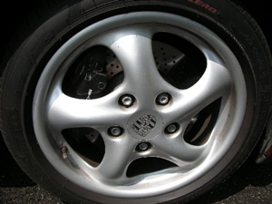

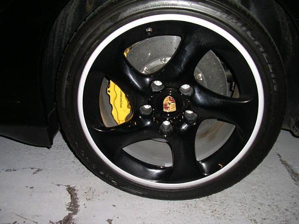

Hi all, I am thinking about painting my turbo twist wheels. I would paint them black with the outside ring speed yellow. Where would I go to get this done? I live in Orlando, FL and would be very helpful if someone can recommend someone. Does anyone know how much this would cost? I have attached two pictures that I found on another forum(if they belong to you, sorry, but for some reason they will not let me register at that forum and ask for permission) And as always, thanks in advance.

djomlas: That looks like a good job from the pic! :clapping:
And that's exactly how I want it, a thin red ring.
Would you care to share your procedures, or do you have any tips or cautions to chip in?
Did you use spraypaint in a can, and did you use a primer or clearcoat?
Edited by CosmosC4S

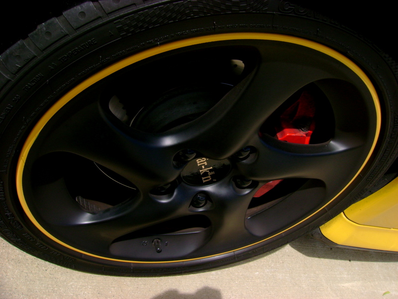

i first cleaned the wheels the best i could, then cleaned them with some steel wool (that took off way more dirt and gunk that i ever tought it would, so give that a try, and then i used a bit more aggressive steel wool to scuff the wheels up a little more so that paint can stick), then i used the rustolium gloss black, put about 8-9 light coats, waited about 10-15 mns between coats, and then put one very thick coat that gave it more shine.
btw, i used the index card masking procedure, so masking took up about 1 minute per wheels.
as for pinstripe, its jsut a pinstripe that you can get at pepboys for $3 that you can use to pinstripe a sde of the car, so it sticks very good, and if you change your mind about it down the road, just peel it off :)
i chose not to put any clear coat
here are some more reference pics for index cards, i painted the back of wheels first
and finished, waiting to dry
There you GO, Pinstripes! I knew I'd learn something...that's an idea, and a good option to consider instead of spray painting.
Thanks, djomlas! :thumbup:
