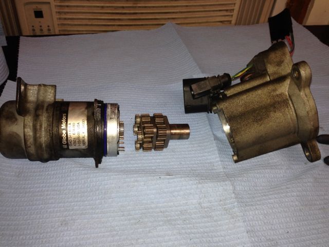

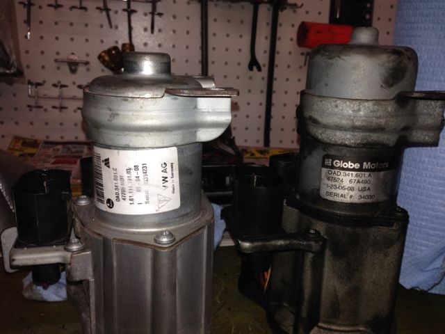

Found a stepper motor from a 2008. Figure it will be a second generation motor and the price was super cheap ($150) so if it lasts only a short time it would seem worth while. Some interesting things…
The motor on my transfer case was made in USA. I went to their web site and they have a brochure that has a picture of a Cayenne. Could this have been a factory part? I don't have any records of my motor ever being replaced but i am the 3rd owner.
The other thing i noticed is that the motor has a planetary gear system. It had no grease on the gears. None. Seems weird that they would build it this way with no lubrication. After taking it apart i could only come to the conclusion that the plastic sensor on the front must have gone bad. The motor and gears all looked good. When i installed the new used motor i didn't have any symptoms like before. So this issue is fixed for now. Hope the made in germany part holds up better than the made in USA.
