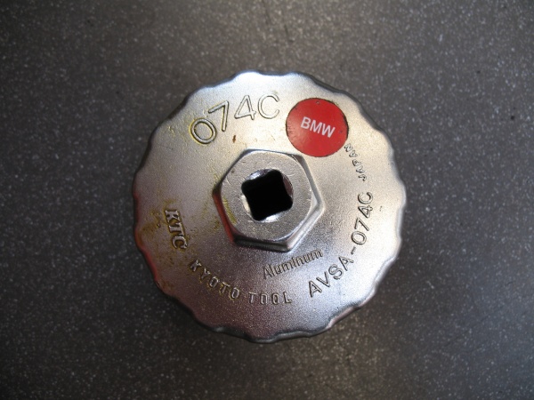

It is made by JTC tools in Taiwan, but I could not find the model 1235 on their site. http://eng.jtc.com.tw/ I cannot see why it would not work on a Porsche. It does look shorter but there is a Porsche mechanic at my dealer that uses a BMW wrench made in Japan by Kyoto tools. The wrench only needs to grab the bottom of the filter cannister.
Go down to your local Pep boys, Kragen, Napa, or what ever is the local auto parts store and get yourself a FloTool #7 oil filter wrench. They are about $3 and fit the 996/997/986/987 oil filter canister just fine.

"Cause I was at work I sent my wife to one of the local auto parts stores (with a good description and pictures), and the guy gave her one that didn't even have the right number of flutes! So into another store this weekend, and I now think I have one that works - a Plews LubriMatic #2. It seemed to fit OK when I put it on the filter. We'll see when it's time for the next change.
