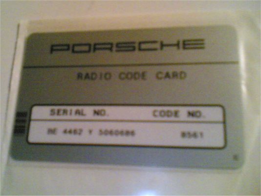

Im surprised at how many people loose this card, It comes in a plastic bag with your head unit instruction manual
Do you remember having a card that looks like this?
