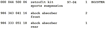

Loren or any other parts guru - I've had the ROW M030 suspension upgrade on backorder since late last year for my 2001 2.7 Boxster 5-speed. The part number Sunset quoted and ordered is 000-044-500-06. Is this the right part number? I can't tell from the parts list. Posts on this and other forums have indicated people are getting the kits, but for some reason this particular part number isn't shipping. I presume the upgrade is year and model specific - is that correct? Did the springs, sway bars and shocks change from year to year or something like that, and that's why some versions are available and others aren't?
Sunset is checking with Porsche in Germany. Is there some substitute part number that works or doesn't work exactly the some? Or is there a trick like ordering all the parts by individual part number? If yes, is there a breakdown of the specific parts in 000-044-500-06?
That is the correct part number.
Since it is a "kit" there is always the chance that one or parts is holding up the order.
Here is itemized list:
Thanks for the quick reply, Loren. Looking at the parts list, I'm curious. Why only one rear shock absorber? Shouldn't there be one for each side like at the front? There are 2 listed for the front. Or is this just a misprint?
What does the red/yellow "Identification" mean? Coil spring colors?
