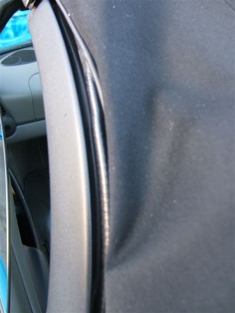

I have a question on closing the hood. The hood’s rim does not automatically align/seat in the “channel” provided (refer attached photo).
I have to manually align it half way through the closing stage.
Is it a common issue?
Any suggestion on how this can be resolved?

i randomly have this problem. sometimes it'll close fine, other times it'll do what your first picture shows so i have to reopen 1/2 way, go out, tuck that piece in and close again...
I think there is a strap on the inside that holds the top in place. It has come apart on my 1999 Boxster.
Mine does it all the time. You are supposed to turn over a leaf spring, located sort of above the seat belt location, held on by two screws, which has deformed through age. Tried that, no use. Bought new springs, no use.
Cannot get an answer anywhere on a fix.

Its actually a braided steal cable that is sewn into the side edges of the top to firmly seal into the top of the plastic window trim... When the top is halfway opened, you can see the screw mounted location of the torqs screw holding the thin braided steal cable on near the bottom edge of the plastic window trim. I think what causes this is the top canvas being very tight and pulls one cable out of alignment before settling into the channel, you should try closing it properly and having an upholstery shop steam the top of your canvas to help stretch it out and leave the top closed for a week before testing if it worked or not.
OR first you can try appling ArmorAll to the area in the picture below to allow the cable to more easily slide into place.
