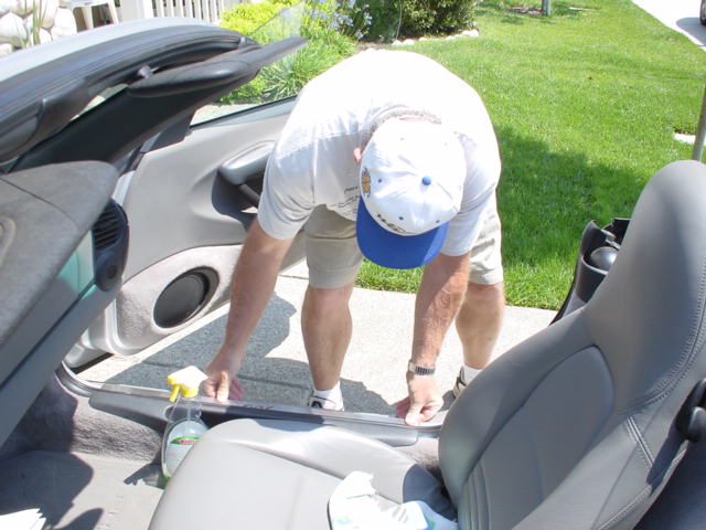

I'm purchasing a set and wondered if anyone has instructions on how to position them. Possibly a measurement from the door latch or something. Any help would be appreciated.

Thanks for the reply, Loren. Unfortunately, I'm not replacing sill guards, I'm installing them on bare sills. I was hoping someone might be able to send me the measurements or post a photo so I would have some idea of the positioning. Maybe I'm making too much of it and it will be obvious when where they go when I actually get them, but I thought I'd ask.

Not sure if it's spec or not, but I recall reading somewhere (and used on mine) something like:
-use a piece of tape 15.25" long, and measure down from the bottom of the door striker following the contour of the jamb to locate the position for the rear edge of sill
also, using the contoured shape of the rear edge of sill, you will be able to locate where it should go w/ ease as the jamb is beveled to fit.
