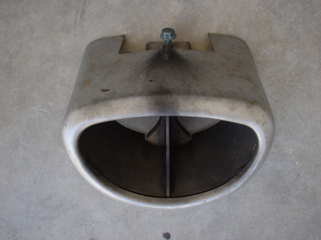

Anyone have the part number for this? I'm about 3 days away from having an 03+ PSE in my hands and I'd like to finish off the install with this tip.
986 111 980 01

The 2003-2004 sport exhaust uses a bolt on tip just like the standard 2003-2004 muffler, but no tip is included in the kit. There are 3 style tips that you can bolt on. All the tips are cosmetic so it is a matter of looks.
The tip in your picture is the most expensive, and I hope you are sitting down when you check out the price.

Also, I did order the tip pictured in the first post. Sunset had it for a tad under $500, Suncoast wanted about $100 more. I didn't even bother with my local dealer. I figured if I was going to drop a ton of cash simply to hear the exhaust more, I'd do it the way I wanted it. How exactly does it attach? The holes on the muffler have almost no metal sticking out.

At first, I couldn't figure out how the one little bolt is going to hold the tip in place, since there's no pipe sticking out to clamp it to.
Looking at this pic, it's now obvious. The bolt fits through the oval hole in the bracket and the front of the tip simply butts up against the muffler case.
