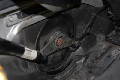

Here is a picture of what i found...I do have RED cable connectors so that is a good thing.
But i did find a rubber gasket/washer/whatchamacallit and it looked broken.
Here is the piece. Is it as easy to change as it looks? Just undo the bolt and re and re?
Thanks again
White is the color of the new style plastic joints.
That is a rubber bushing. I cannot tell if it has split or just become displaced. It is there so you do not get rattles. Might just leave it alone.
Sure ruin my night.....I thought i was lucky with the red ones!
I don't get any rattles from the top but when it goes up and down it appears to stutter. I put some grease on the track so i will see what that does.
call sunset, i just replaced one of mine, i had one red one, and of course it broke leaving my top in halway position, it was 42 bux for one, so 80 bux gets you a piece of mind with that, and install in as simple as unbolt old and put new in.
