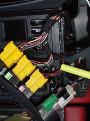

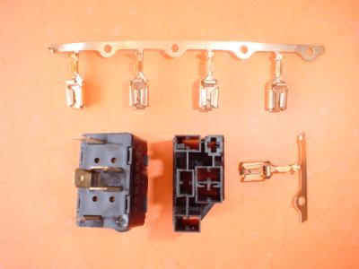

I would like to have the partnumbers of the dash switches socket housing and socket contact, there different colors but i need the black and green housing.

You mean the plug for the back of a switch? I thought on the early cars they were all the same color - yellow on my 1997.
The plugs are not listed by colors, but by the switch the plug goes to, so need to know what switch.
Or, you can buy a generic black one from VW.
yes I mean these switches.
Mine have different colors so you know which one to plug in what switch
The swith is the TC and the spoiler switch.
thanks
The spoiler switch plug is 999 650 035 40 and the pins are 999 650 330 00.
The plug listed for traction control is 999 650 107 40 but there is no way to tell if it has the correct color. The pins are 999 650 103 12.

Wel I added the the dash spoiler switch and like it the OEM way...
And I broke the TC socket ;-)
