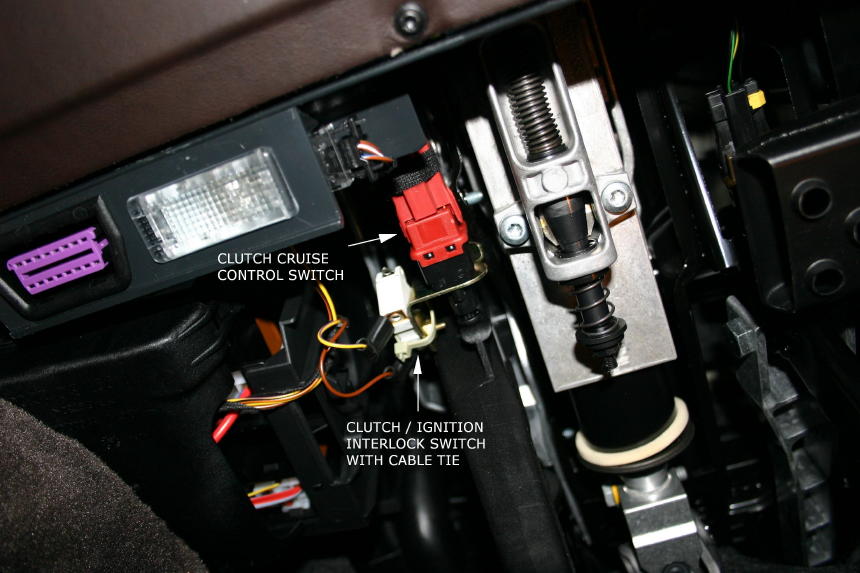

On my '99 996 it was easy to disable the microswitch that controlled the clutch/ignition interlock with a cable tie. On my new 2007 Boxster S, however, while I can hear the switch operating I can't see it; the clicking noise seems to be coming from behind the firewall. Apparently the design is different from the 996. Before I start taking stuff apart can anyone give me a clue as to where the switch is located and whether something more complicated than a cable tie will be needed to disable it?

Thanks Loren. My problem, though, is that I can't even locate the dang interlock switch! It's not in the same place as my 996......the "click" seems to be coming from behind the firewall. I found another switch which is actuated after only an inch or two of clutch travel (I'm guessing that's for the cruise) but I have to depress the clutch almost all the way to close the other switch and allow the car to start. Where's the interlock switch located? Any ideas?

  Loren said:
Here are a couple of different angles.
The one highlighted in yellow should help.
That's it! I don't know how I missed it.....guess I was fooled by where the sound seemed to be coming from. Thanks Loren.

I did my little mod today on the clutch/ignition interlock. It took all of 2 minutes to secure a cable tie around the switch to hold it closed. The engine will now start without having to depress the clutch for those occasions where that's convenient and there's no more "click-click" whenever the clutch is operated. There is no problem with the cruise control after doing this mod....it works properly as before. Legal disclaimer :rolleyes: : of course the ignition is no longer idiot proof-you must check for neutral before starting- but we all do that anyway. The photo below shows the locations of the clutch/ignition interlock switch and the cruise control disengagement switch. Cheers!
